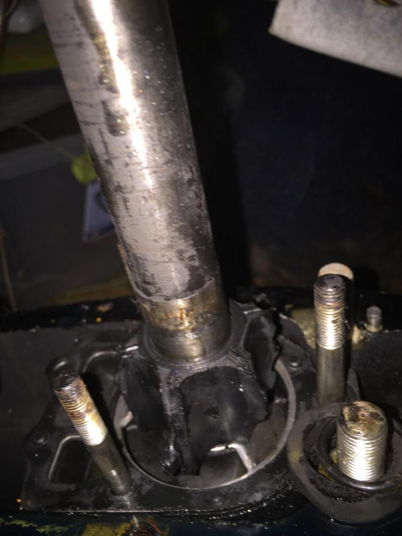

Okay so I tore the lower unit off today and this is what I found.......... so I will replace the water pump and let you guys know
Mark, you will want to retrieve the missing impeller vanes.
This will involve taking certain parts of the cooling system apart...... but it will be well worth it in the long run!
If you DO NOT retrieve them, they may become lodged and may restrict flow somewhere within the system.
This could result in over-heating issues.
Ok willing and ready where do I start ....
I would start at the curved hose that leads from the bell unit to the transom unit… I would then go from there all the way forward.
Leave no stone unturned!
