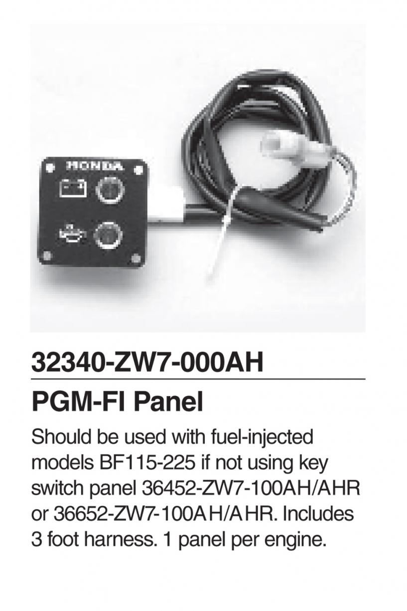

Glad you found the problem. On your first post, you said that you shorted the red plug to check for codes. The light that you were supposed to watch (PGMFI) was not there.
For future troubleshooting, you should have two more lights. One for PGMFI and one for Charging.
I do not know how old you motor installation is, but most since the 225 was introduced most cabling included the connectors at both ends for the PGMFI panel like this one. ml.rerap45a.MAC_Key_Switch..jpg
The three pin flat connector is probably under your dash somewhere hidden inside your wiring harness.
It is very likely, that you would have found the problem right away if the light was there.
