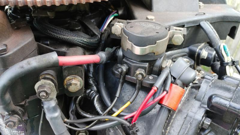

2000 225 Ocean Pro. Is there something I can unplug to disable the ignition system to do a compression check? Or do I really need to go through the hassle of grounding all the spark plug leads?
No need for the ignition switch to be on.
Using a small jumper, connect from the large battery cable terminal of the starter solenoid to the 3/8" nut terminal of the starter solenoid (Not The Ground 3/8" terminal). That'll crank the engine over with "No" ignition.
BTW.... In my 38+ years, I never bothered to ground a spark plug wire when doing any test... and never had a problem of damaging any components. I did start one hellava fire one time though with all that fuel shooting out the cylinders.![]()
