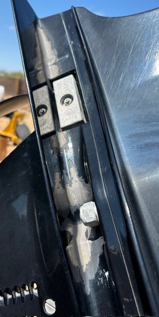

I’m looking at a to a 2019 pontoon an it has a 150 hp on it an the paint is chipping right joint have you seen this before

That is cavitation burn...3rd toon and front of splash deflector causing it. Just use appliance epoxy black to repair
