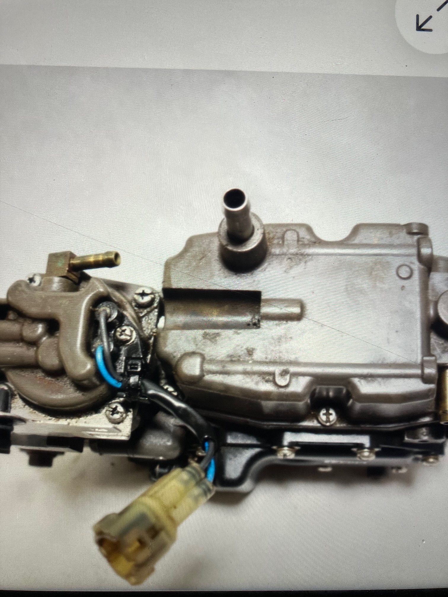

Hi again. I located a complete working used vst Assy. It bolted up perfectly and all the hose connections were the same except 1. She fires right up and purrs like a kitten. Question I have is does the different hose location make a difference? Parts catalauge says it is regulator relief hose. I’ll attach the pics. The first would be the one I took off and the second the one I put on. Ed
Sorry. Forgot to attach the one I put on. I’m computer challenged. The one I put on. The smaller nipple I am referring to comes out tight near the bigger one on top. I hooked the hose there. Not sure what the long term effects will be but seems fine right now. Ed
