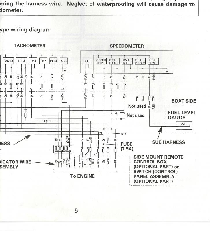

I needed to get accurate fuel figures from my honda 225hp 2006's.
In my case I have installed the digital speedometer (it's not very cheap about 600 bucks in the USA) by doing this you will have very accurate fuel usage figures... I can walk you through installing it if you decide to go down the path... I run the digital speedometer (it will give me total fuel use, km/L, and all those sorts of figures) I am still running the traditional analog tacho's as they are a lot easier to see/use.
anyhow if you need a hand get in touch... I also sent CHawk a copy of a wiring diagram I found helpful.
Either way... hope you have found an answer... it wasn't cheap but that was the best one I could come up with and the fuel use figures are spot on.

i have twin bf225 2006 rigged with digital gagues dont get the gph reading everything els works fine
is any one have the schematic drawing
thank you guys

I have the 2006 BF225's and the original Honda gages, the fuel flow and total fuel usage shown on the gages are spot on. Have no idea what the temperature is though....
Let me try to upload the diagram.
