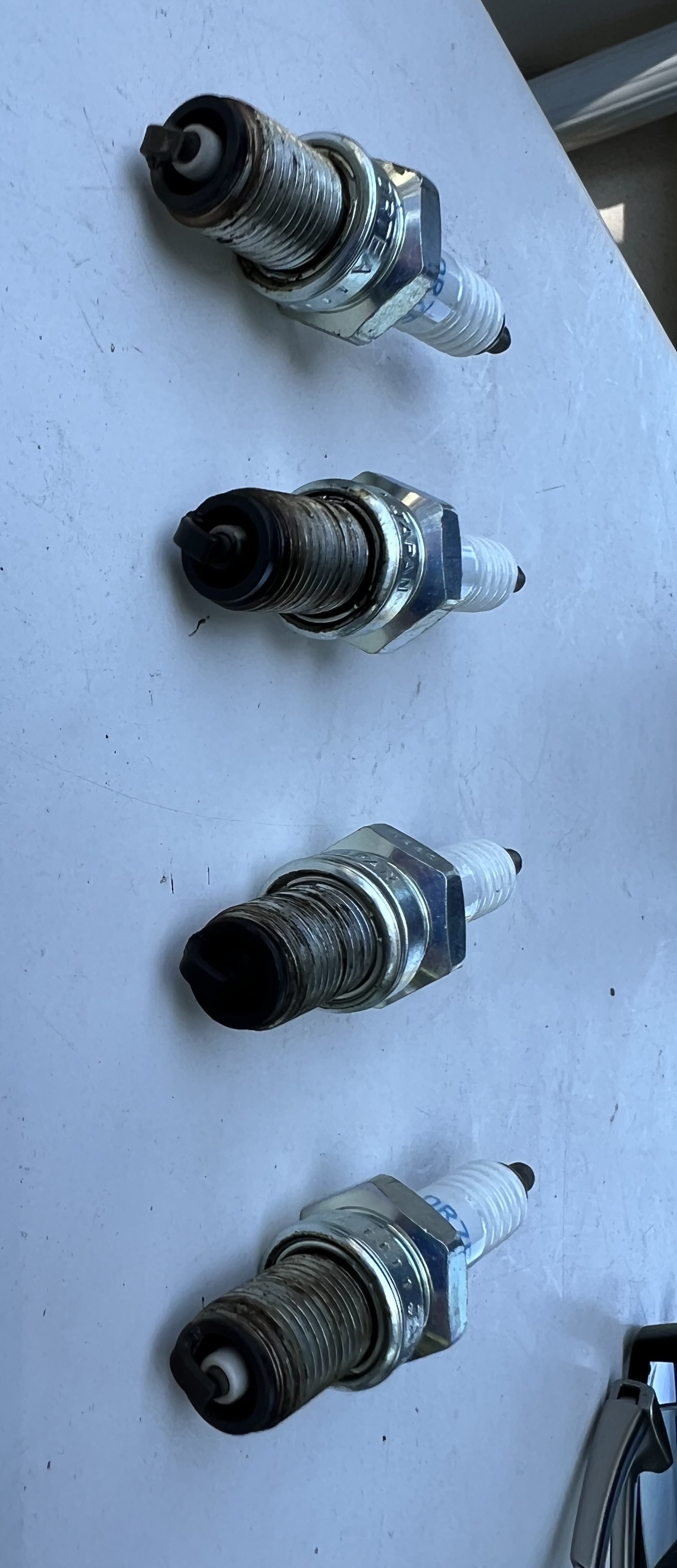

Gas is good, changed plugs, old plugs are top to bottom just like the pic, tried to meter the coils, tab to tab got 0.03 /tab to plug socket got nothing (tested a new coil and got the same readings), what could it be? Pulled the plug caps while running and 1&4 make no difference in engine sound.
Your coil measurements sound like they're probably normal.
Running on only 2 cylinders and the #2 and 3 plugs look fuel fouled.
