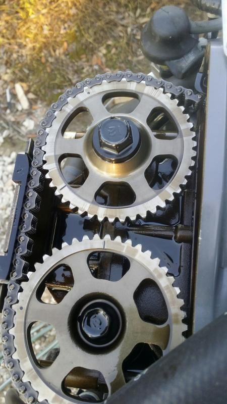

I have read ever post on this site and have read some great ideas, unfortunately nothing has worked. I bought the motor off ebay and it was advertised as none running with 180 PSI Compression on all four cylinders. I have confirmed it has 190 PSI on all cylinders. The motor has excessive soot on the prop and lower unit, Plugs were sooted over. Changed plugs with new NKG and new air/fuel sensor. It has 48 PSI at the outlet of the high pressure fuel filter. Changed the intake air bypass and inspected the throttle body. I have a honda service manual and resistance checked every sensor that I can. I installed jumper on red plug and no codes are showing up. It will start up about half throttle, but runs very rich. It will die as soon as the throttle is moved towards neutral. No buzzers other than the 2 second beep or engine lights. It will run for ever at 1500 RPM, but acts like it is running on half the cylinders. Gas is new and coming out of a portable tank. As you can see, I have made every effort to try everything, before asking for help. HELP!
