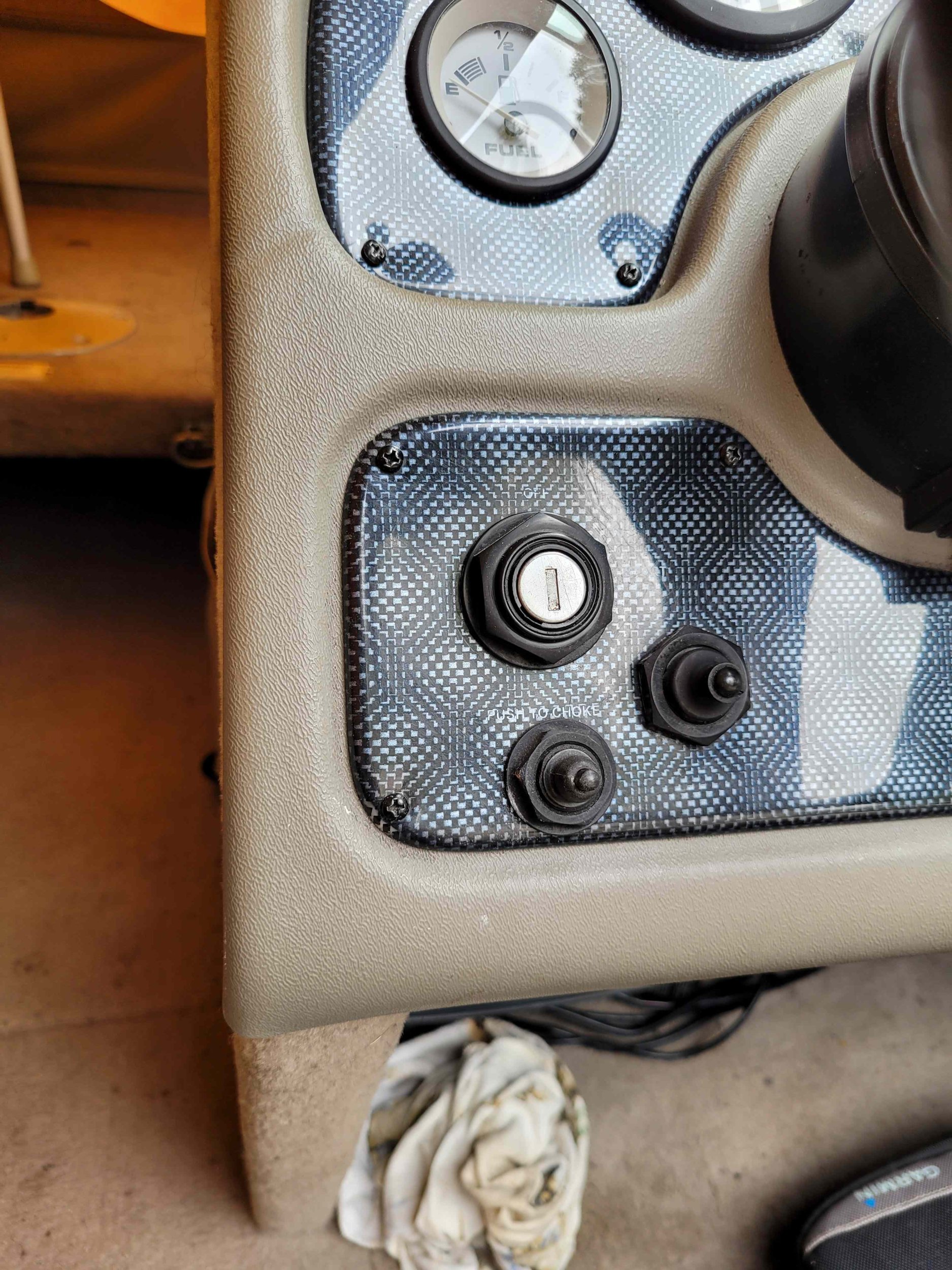

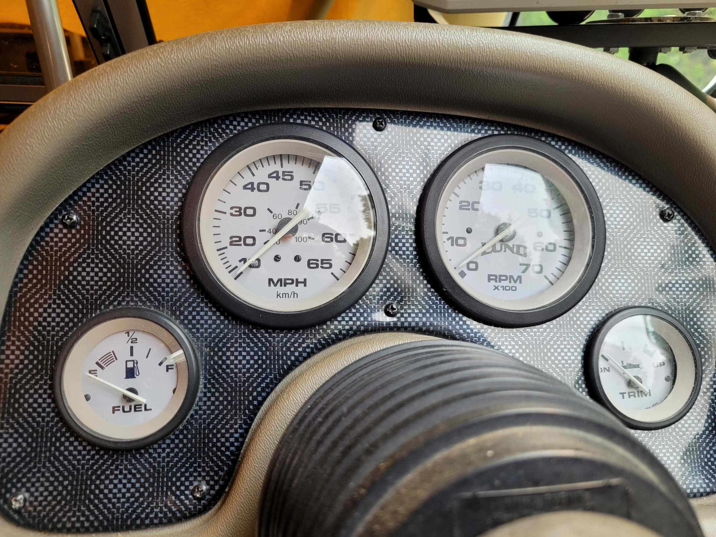

Alan,
It sounds ridiculous, but there are no lights near the ignition switch. There are also no lights/gauges on the panel either. Any suggestions how I can check the oil pressure any other way?
Do you have a binnacle (top) mount control, or a side mount? If an OEM side mount, the lights will (could?) be located there.
To be honest, if somebody installed that motor without installing the lights somewhere, that was pretty reckless in my opinion.
It's a side mount and has no lights as well. The manual provides for the oil pressure and overheat lights next to the ignition switch (and there are none as we know). After I fix this issue, I will try to get the dealer to install the lights where they should be.
USUALLY, a side mount control will include the ignition switch and that manual choke button shown in the picture. It looks like somebody got "creative" here, removing them, extending the wire harness and installing per your pic. Both of those items, especially the choke button, look like they've been relocated from a side mount control. Optionally, usually used in combination with a binnacle type control, they use a small panel that includes the missing lights.
In any case, I would encourage you to have another look at your control. The lights on the black OEM side mount control are flush mounted right near the high idle/warm up lever handle. If they mounted the control with the throttle/shifter arm horizontal when in neutral, these lights may be facing down.....
