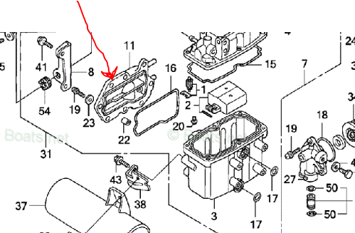

I did find a crack on this part:
MAYBE I cracked it when trying to get the screws on the VST loose with an impact screwdriver but I don't think so. I think that crack could cause a problem as it certainly was passing air. I could spray carb cleaner through it. I used a marine epoxy on the outside and I'm confident that will seal and strengthen it.
