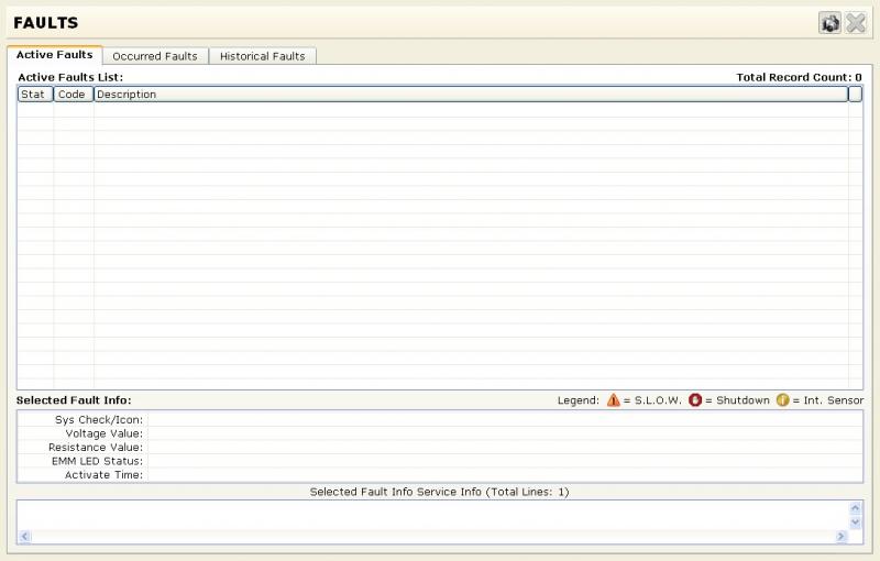

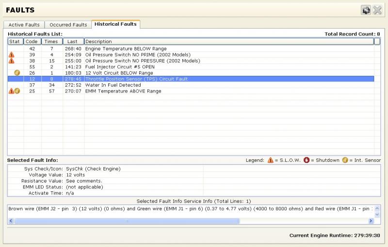

Posting the results of the diagnostics scan. Thoughts? I have only put 8 total hours on the engine. Previous owner had emm serviced by dfi and also had some other work done as well. He doesnt believe that any of the fuel pumps have been changed. I also expected to have a Schrader valve on the high pressure rail to connect gauge to however there is no test valve. How would i test the high side without test valve

Looks like you have a very recent TPS fault, but not a hard fault (happening now). That means it may just be a cable adjustment? Try adjusting the throttle cable trunion at the motor a little. You should be able to see it change voltage on the screen. It doesn't take too much.
The other codes may have occurred before the EMM was rebuilt? The low voltage (battery) can just be if the battery got run down & you had to charge?
Everything else on monitor screen looks good.
Hey T2. I’m pretty sure the first time I fired up the engine was at the 272 hour mark. I experienced s.l.o.w a few times the last time out however the recent occurred faults don’t indicate slow. Am I looking at this correctly or am I missing something?
Thanks Kevin. I thought that may be the case. I thought that the motor was going into slow mode when the problems were occurring but the readout doesn’t show it which led me to believe I had an additional issue. Also the tps is obstructed by the flywheel. Is it possible to replace without having to take it off?
Actually you would set a code for any SLOW action, but not fuel/vapor leaks. I did not see those in the chart. Low voltage will cause the motor to shut down.
You can remove the TPS & bracket assy without pulling the flywheel. The stainless bracket is held by two 3/8" headed screws. (Put a drop of blue Loctite back on threads when you put them back.) You can remove those & pull the bracket/TPS out as an assy. Then unplug the TPS. That is the easiest way to do it. Not much room under there to get it plugged in well. I believe there is a small tyrap to hold the strain off the connector wires. Check the wires in the back of the connector to see that they are not loose or frayed.
