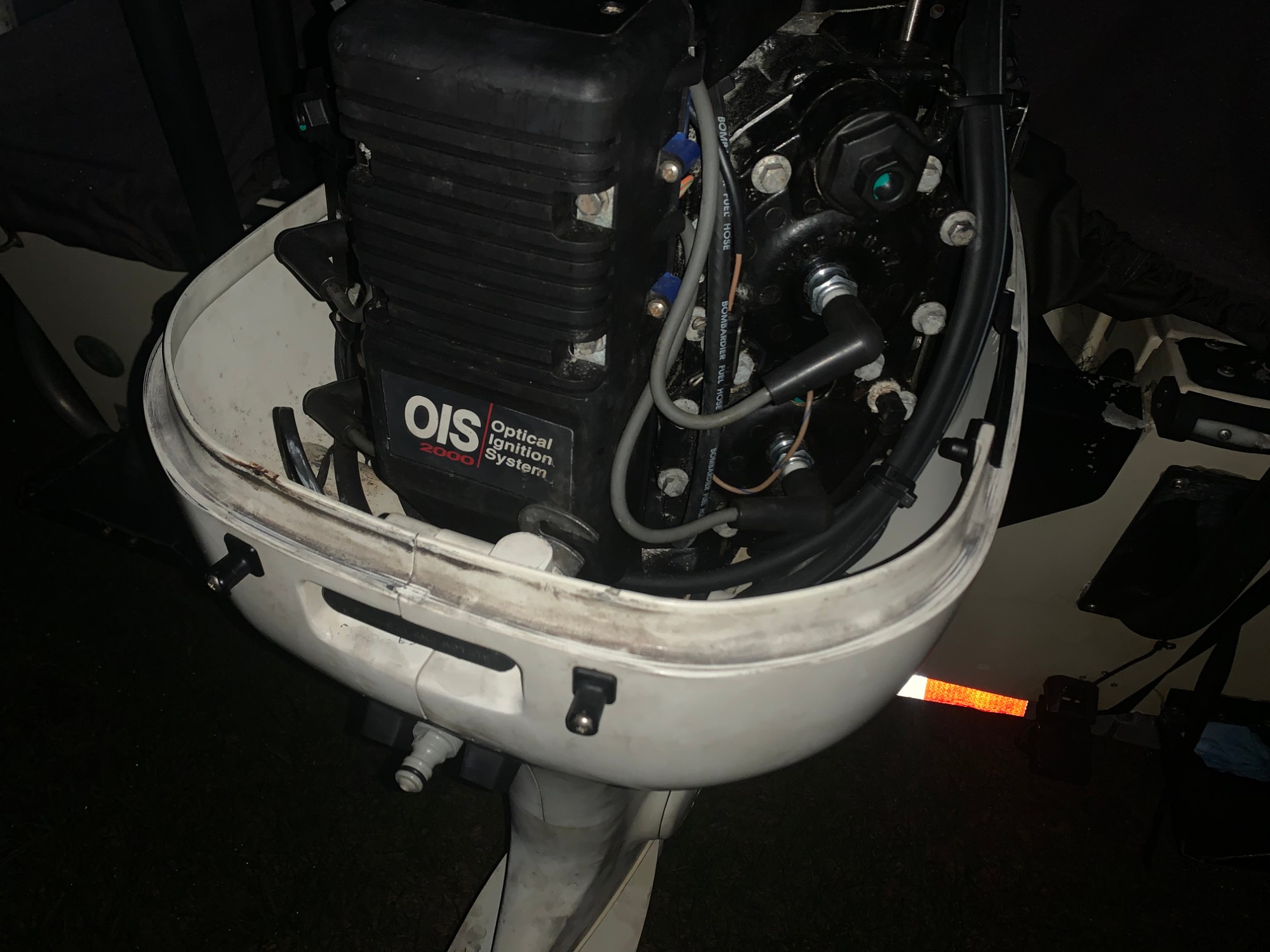

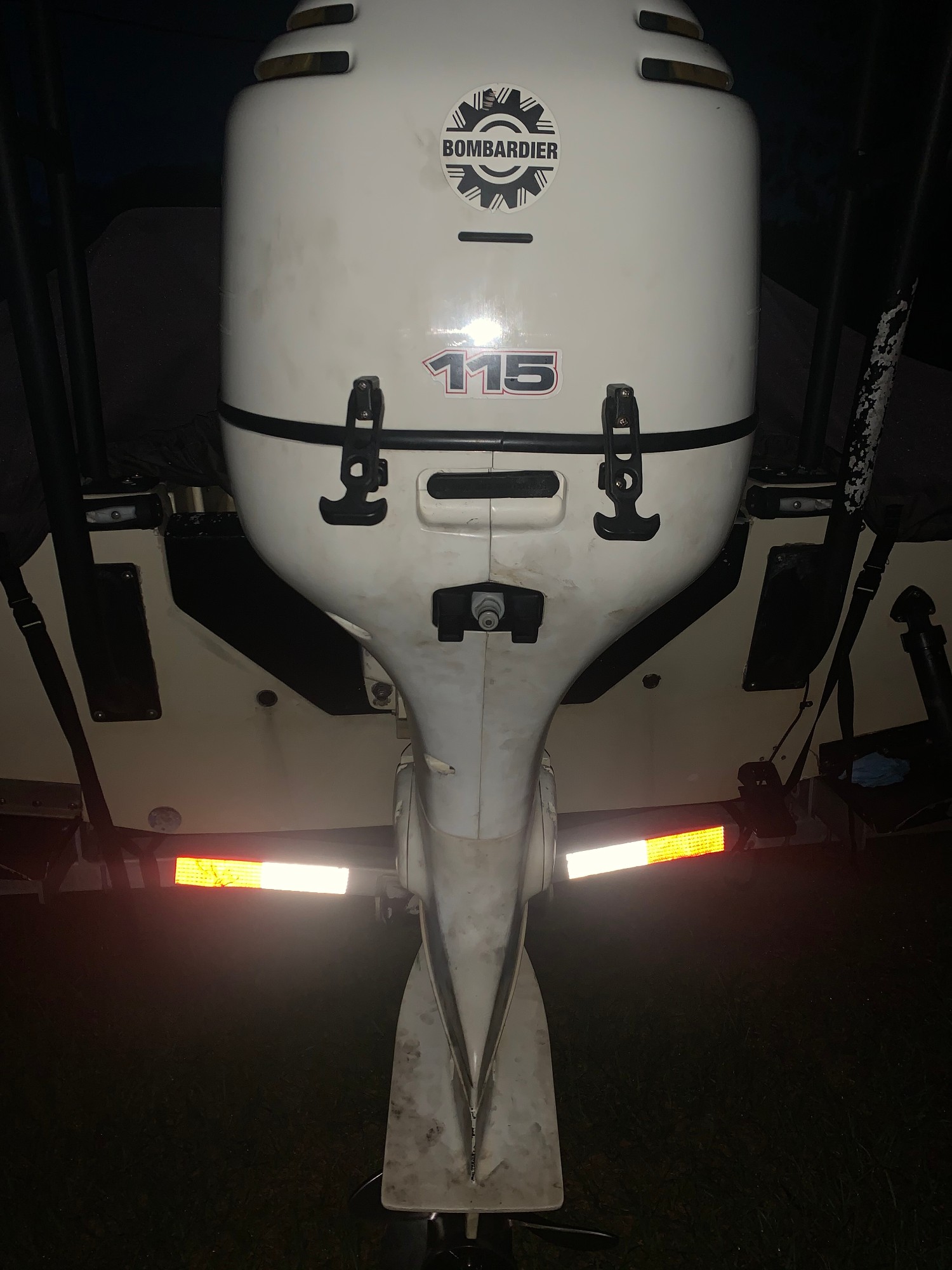

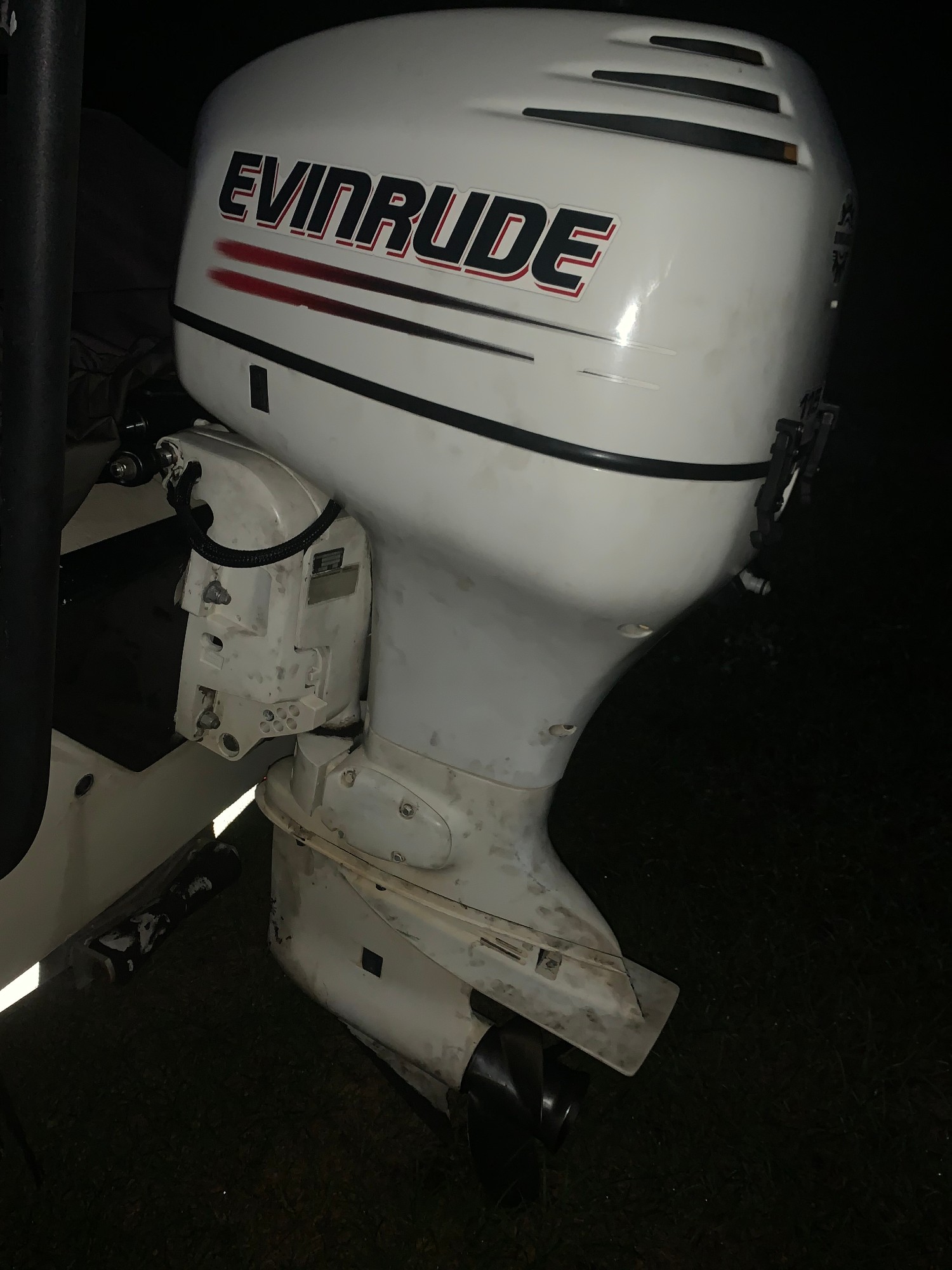

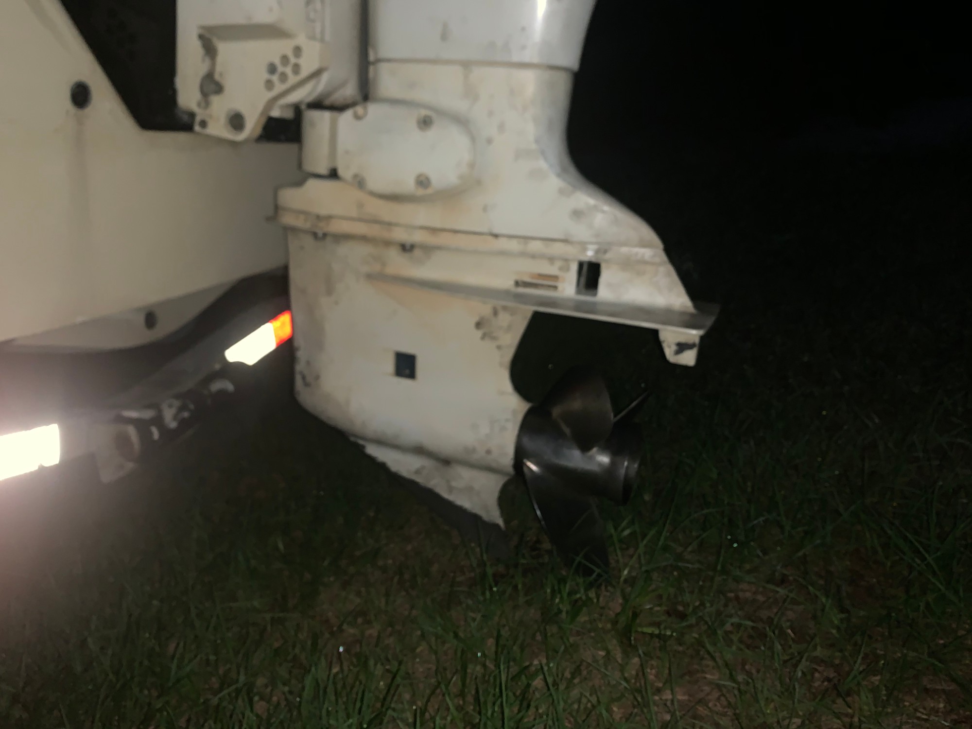

Hopefully this confirms the year and model
Measured from mating surface to the center of the hole at 21 3/4” and I have not tested but forward does not feel correct. It feels as if there is no slow ahead, if you will.
