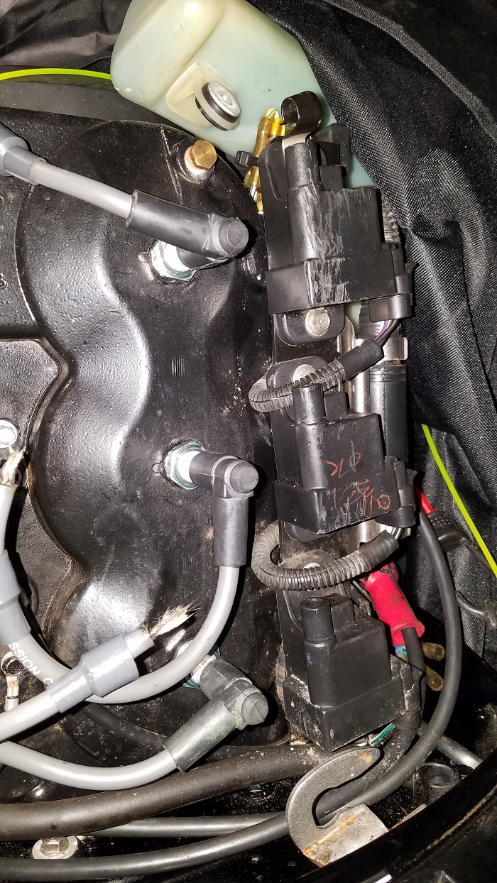

Hello all......this engine is new to me....it came on a 24ft pontoon boat that I just purchased. I am tuning the motor up for Spring and came across this odd scenario. I was checking the plugs when I noticed the top plug wire was not connected to the uhhhhhhhh power pack side if that makes sense. The little boot has such a light grip it can easily slip off while say removing the cowling. Then I checked all 3 and they were all that way.

Someone has torn them out of CDM module...cut about 1/4" off end and rethread them
Wwwwwwhat......... Let me see if I understand what you are saying. So normally these plugs are screwed into the CDM? And in my case someone has ripped or tore them off the threaded portion of the boot??? So you are saying I can fix by cutting some of the boot off to be able to re thread right? I didnt realize the boot was threaded. Orrrrrrrrrr are u saying I need to do this to the end of the spark plug wire....ahhhhh that makes more sense. Ya the end of my wires have like nothing exposed I cant see how it even runs that way. I guess I could also buy new wires......should I ??? Or just fix? I noticed those wires are expensive. I would love to see a youtube vid on this repair....but I think I can figure it out

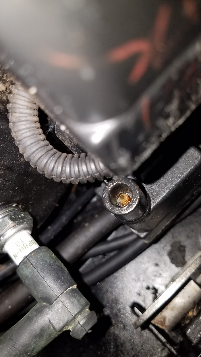

Hey Bullet.....I realize talking to idiots probably drives u nuts but this idiot has a couple more questions if u will pop back on and steer me in the right direction I would appreciate it. Well u were exactly right....I removed the plug wires from the module and there is a screw in there. I trimmed back my wire 1/4 and tried to screw the wire down on this screw but it just wouldnt take.......any tricks to this simple task? Also it seems as if the end of the wires are left on purpose with what looks like conductive strans of fiberglass hair about 1/2"cdm rust.jpg long. Could it be that the wire is just supposed to rest against the screw tip and conduct ....in addition to the hair stuff?

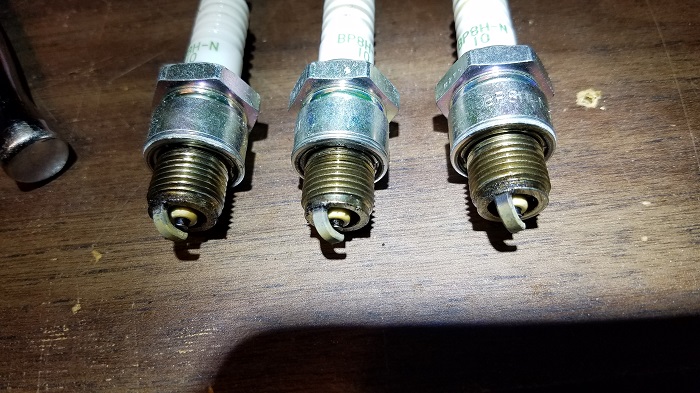

I also noticed that my bottom module had a rusty screw inside for the wire to thread on....should I replace that module or just clean up that screw? Lastly .....my plugs which were very new to previous owner did not look right when I removed them.....they were almost white......what does that mean.....rich or lean? Is it possible my rusty screw module was causing this or should I check my oil injection system.....or typical bad gas?????

So if I only have you for this one last time....there u have it.......any direction would be appreciated.....see picsplugs 2.jpg
Those are suppressive wires and thiose are carbon strands. Take a razor blade and cut em off flush, use rubbing alcohol to lube the wire and screw it back into module. The rusty one you can insert some steel wool into area and use a small carpenter trim nail to move it around and remove the surface rust. The plugs look ok but but if engine has sat a while it would be advisable to inspect high speed jets in carbs.
Thanks for coming back Bullet. Ok I will get those wires on those screws come hell or high water. I ordered another module off of ebay to replace or just as a back up for the rusty one....I already cleaned up the screw. I will check it for spark once I get it hooked back up again. Right now it is on a stand waiting for the boat to be done.
