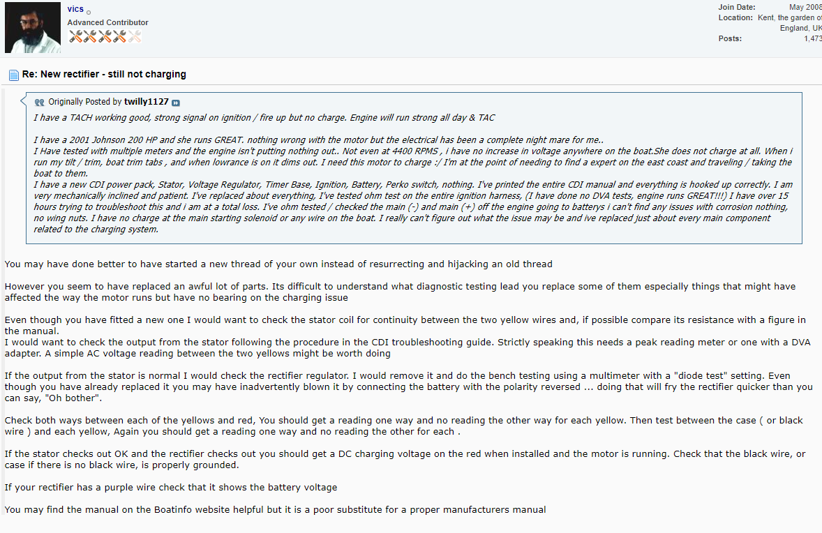

You may have done better to have started a new thread of your own instead of resurrecting and hijacking an old thread
However you seem to have replaced an awful lot of parts. Its difficult to understand what diagnostic testing lead you replace some of them especially things that might have affected the way the motor runs but have no bearing on the charging issue
Even though you have fitted a new one I would want to check the stator coil for continuity between the two yellow wires and, if possible compare its resistance with a figure in the manual.
I would want to check the output from the stator following the procedure in the CDI troubleshooting guide. Strictly speaking this needs a peak reading meter or one with a DVA adapter. A simple AC voltage reading between the two yellows might be worth doing
If the output from the stator is normal I would check the rectifier regulator. I would remove it and do the bench testing using a multimeter with a "diode test" setting. Even though you have already replaced it you may have inadvertently blown it by connecting the battery with the polarity reversed ... doing that will fry the rectifier quicker than you can say, "Oh bother".
Check both ways between each of the yellows and red, You should get a reading one way and no reading the other way for each yellow. Then test between the case ( or black wire ) and each yellow, Again you should get a reading one way and no reading the other for each .
If the stator checks out OK and the rectifier checks out you should get a DC charging voltage on the red when installed and the motor is running. Check that the black wire, or case if there is no black wire, is properly grounded.
If your rectifier has a purple wire check that it shows the battery voltage
You may find the manual on the Boatinfo website helpful but it is a poor substitute for a proper manufacturers manual
