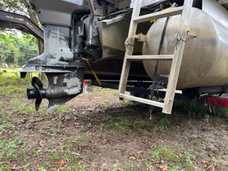

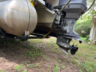

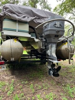

Serial number is J90PLSSE. Motor is on a 22' crest pontoon.
-Motor starts strong. Idles good. Does have a slight hiccup while idling but nothing serious. Once I start throttling it it smooths out and runs great at trolling speeds. Once i get past trolling speeds and try to get on plane it feels like prop slip. The rpms rev slightly and it loses all power. Once I decrease throttle back to trolling or idle the power comes back. I thought it was prop slip and replaced the prop with a Turning Point prop 14x13 which was the original prop specs. The issue is still there.
