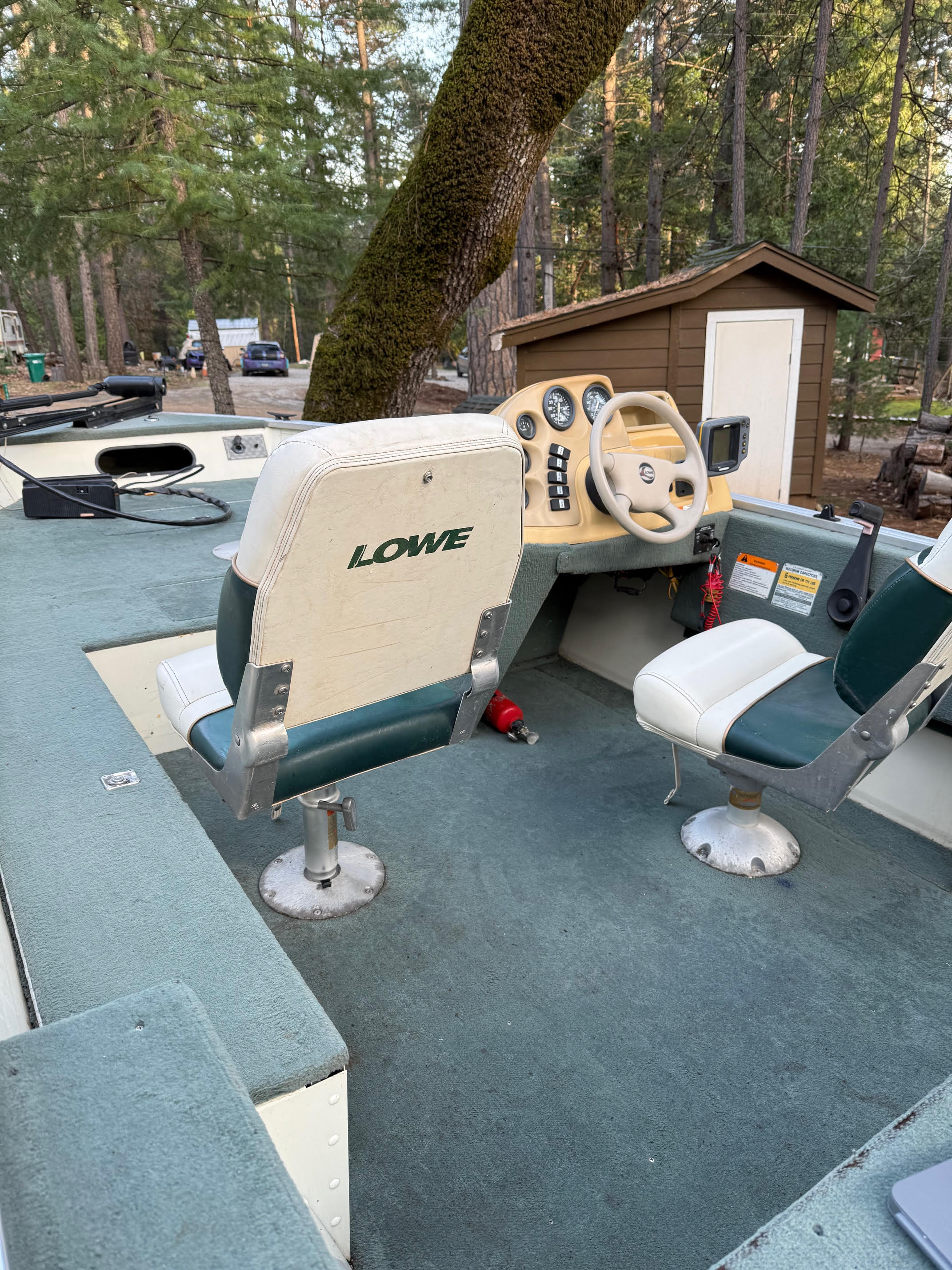

Added some pic of the boat. Using it as much as possible before I do a full gut and replace. I want to get the feel of it so i put it back together just as I think it should

Nice looking boat. It looks very similar to my '83 Fishermarine 16'
A very comfortable and stable fishing platform. It's fairly lightweight and will launch in a little more than a cup full of water. I could fish when the water levels were down due to drought and the guys with the glass Rangers, Champions and Skeeters had to find something else to do.
