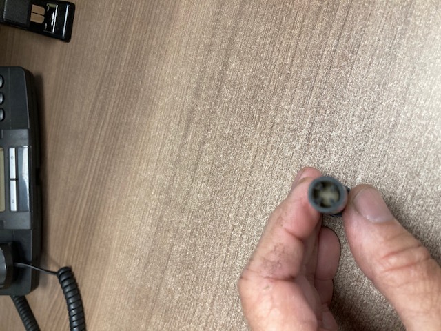

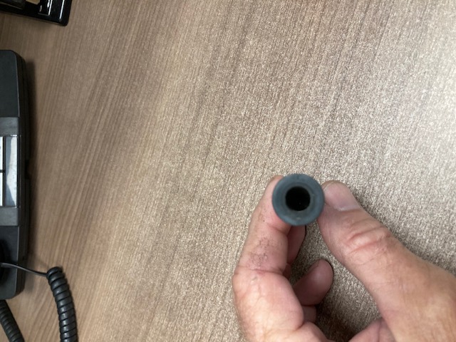

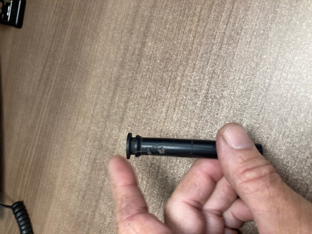

can someone tell me what this is and where it goes. I found it laying in the bottom of the motor case

Cowling drain...... Check spark as sound like you lost a bank
thanks I will find where it goes and put it back. I will be testing the spark with a inline plug tester next. I just remembered I have another question, on the right head there is what looks like a temp sensor, but it has a plastic end with 2 barbed fittings, one of them has a hose on it the goes back to the carbs, the other barb is just open, 2 questions about it 1) is the one barbed end that doesn't have a hose OK to be open like that, 2) is it OK for the plastic part to spin around loose from the metal part that threads into the head. is this some kind of enriching sensor allowing vacuum to the carbs when open or something along that line, or maybe part of the choke system
