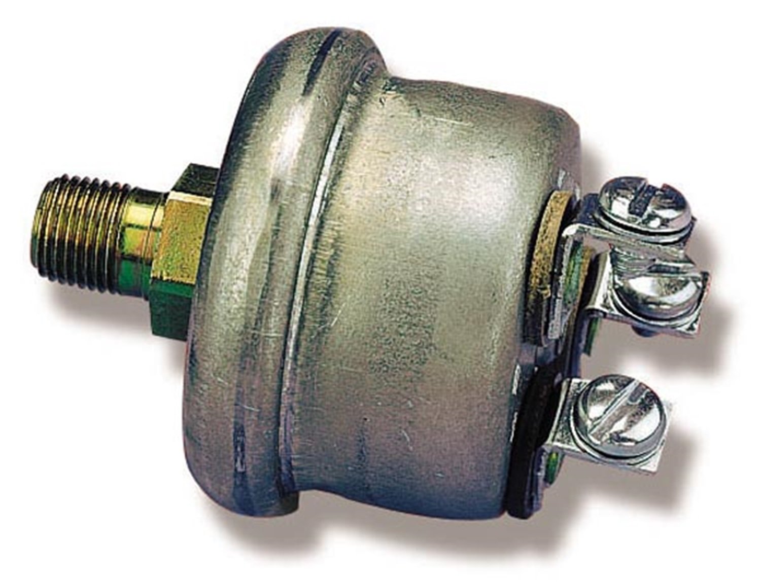

My Mercruiser 4.3 Alpha 1 will start right up but will stall in 10 seconds. Bypassed the oil pressure switch after reading about similar post by jumpering the leads with a paper clip and it will start and stay running. Bought replacement switch at NAPA to replace old one that was PN 87-864252 and leaking oil out the end. New part number 87-4252A01 and had to splice new ends on it. Put it all together and I still have the same stalling issue? If I bypass the switch with paper clip it runs fine. Also only hear the file pump when I bypass the switch.
