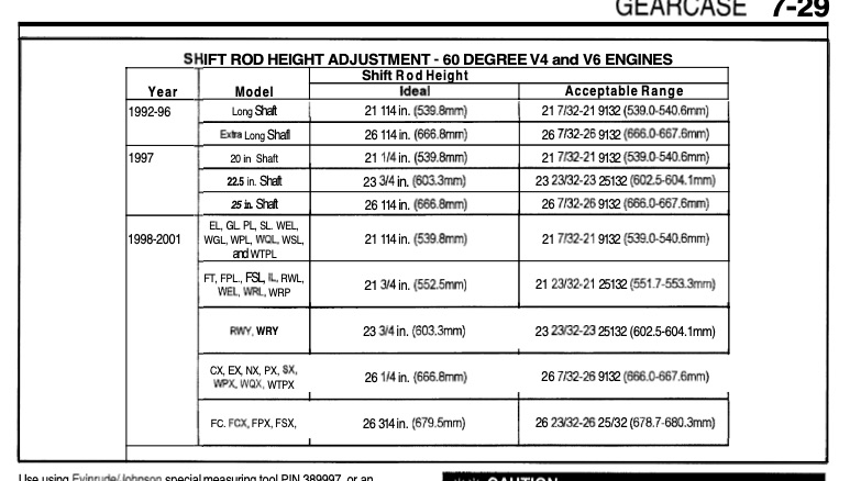

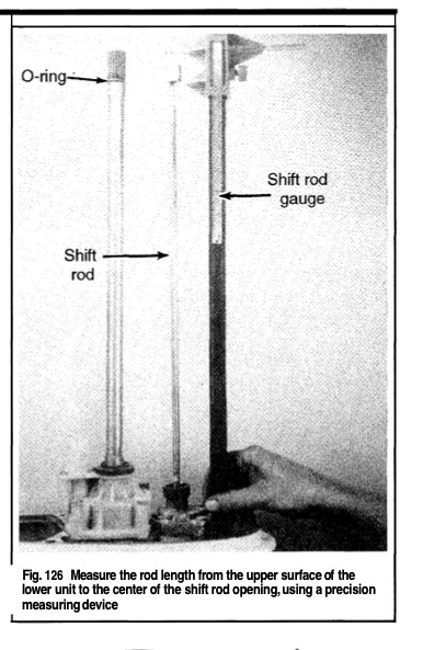

This is from shop manual. Because adjustment is limited by thread pitch you do not need a caliper to set it, the exact measurement can be off by 1/2 a turn shiftrod table.jpgshiftrod I.jpg. I made a gauge by carefully laying out the dimensions on a peace of hardwood.
You're right, it is, it actually came with the diagnostic software that I bought on e-bay and I think came from Croatia but the software works. After I posted it I looked at it and realized it didn't do a good job spelling out the engines it covered. I do have the official factory manual and prefer it but I have found that the aftermarket manual provides more inside into how things work than the factory manual does which helps me diagnosing my 2000 225 Ficht that i refuse to give up on. (I'm learning a lot, mostly the hard way) +/- 1/32" is a 1/16" range which can be measured with an accurate tape measure. I resealed my lower unit in the spring and counted how many turns unscrewed the shift linkage. I counted the turns putting it back in and checked it with the fixture I made and found it to be right on.
