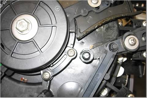

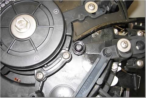

Not on a 60 degree motor.... the 1st pic is how it should be set, the 2nd picture is incorrect. Timing is adjusted with a timing tool not a timing light as it optical ignition.
Thanks ALOT for many good answer from you, i will now take a look at some issues, i will let you know.
FAZTBULLET......i went out to the garage and had a look at the screw you showed at your pictures, my motor had the screw the wrong way pic 2, i adjusted it like pic 1 and now the carb close totaly.
I will start it up one of the first day and let you know, i am no very optimistic....when it is the wrong way like on pic 2 will it also cange the idle timing ?
This motor had to high idle with a little missfire but not mutch, when i gave it throttle it run perfect...so maybe this "small" adjustment fix both problems...high idle and small missfire....i hope this will fix my problem.
He posted ONE picture of ONE screw....and that screw/adjustment was wrong on my motor....cant wait to try it agein.
