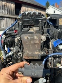

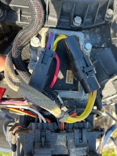

Here are a few photos of the ignition coils. Is there any chance both would stop working at the same time? I cleaned connections and still no start.
