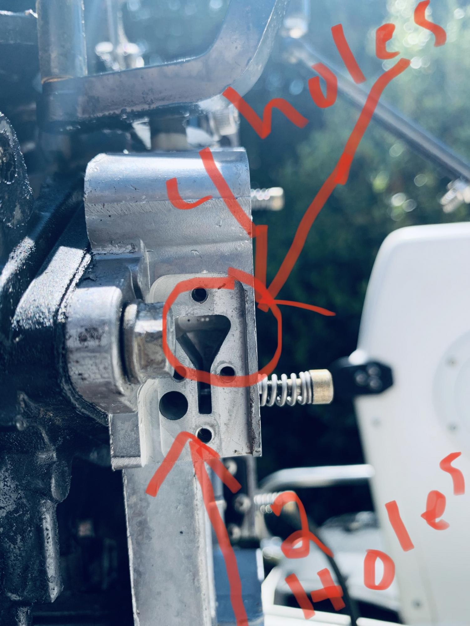

Ok I’ve cleaned carbs and waiting on kits. Removed TB covers, gaskets and valves. I kept everything in order to put back as it was. Do I just clean out the two holes in front one is where valve screws in and other is above it? I kinda see a small hole at the top where cover came off. It may actually be two or three holes. Are these holes too that need to be cleaned?
8C1F1FD8-CAE3-489C-A080-496530C997F0.jpgOk I put my glasses on and actually I found 4 holes in the top and 2 holes in the round side one. I ran a small wire through all holes with choke cleaner and compressed air. I can see through holes now also
