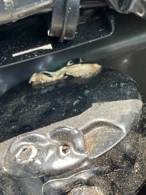

I opened the engine cover and tried to identify the issue. Can somebody tell me what this is? And it seems it is leaking a bit. Is this a big problem? Thanks!
Well, that looks like the starter and solenoid assembly to me. And, it looks like it's been pretty dang hot too!
I think that you may have just found your cranking/starting problem.
For reference, see items 6 and 42 in the link below
Item 6 is the gray colored cable cover at the top right of your top photo.
Item 42 is the yellow fuse holder cover at the bottom left of your top photo.
Item 23 in the link below is the gray colored, heat distorted component that is the focus of your bottom photo.
