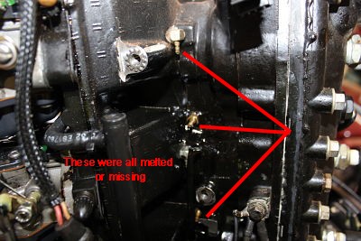

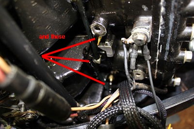

Hi, I'm looking for a diagram of the oil re-circulation hoses as mine have either melted or fallen off. Can anyone help, to fit a 35 hp Evinrude
Back again, motor played up more next trip out, was over heating. Check thermostate and was melted. Running without one at the moment and motor running well. Next problem, I can not find a thermostate any where in this country (Australia) and doesn't seem to be any where else either. I need a new on to fit a Evinrude Elan 35hp. Model: BE35AREDGIMG_1344_opt.jpgIMG_1345_opt.jpg
that model doesn't come up on this site but if you change the "G" to "S" that works, they don't sell the assembly but 9 separate parts to make one
