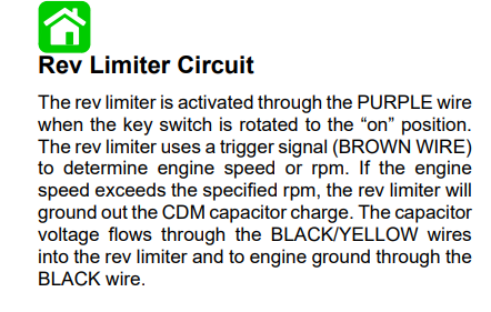

Ok here we go. I bought a 1996 115 2+2 merc serial # is OG 466864.Motor runs fine up to about 3000 rpm but then it starts knocking like its pre detonating kinda like a car that has the timing too far advanced.In my manual it shows switch boxes but this motor has cdm's .When did mercury make the switch to cdms?It has a rev limiter which when kicked in advances the timing to 30 degrees per my 100$ manual..Im thinking this may be the problem.How do I properly by pass it?I was told to just unplug the purple wire coming out of it but I
m leery on doing anything until I can get some more info.Any help would be appreciated.

The knocking is a red flag.----I suggest you do a compression test.-----Post the actual values here.-----I doubt a rev limiter advances ignition on outboard motors !

From the real manual...(90-830234R3)
