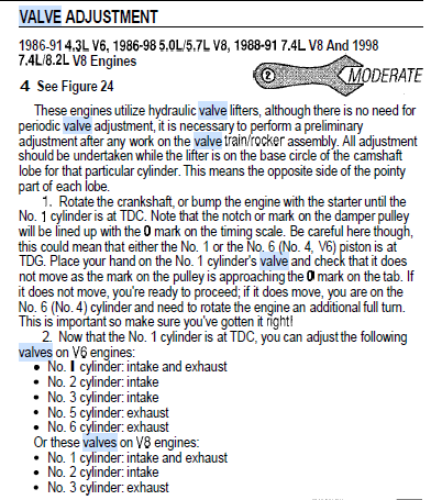

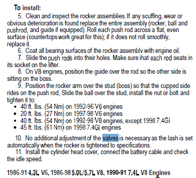

I will be replacing a head on a 1993 OMC Cobra 4.3 Model number 432APRJVN The manual that I have states to torque head in 3 steps to 25, 45, 65, and torque valves to 40 ft. Ibs. on 1992-96 V6 engines. so this means no lash adjustment for this engine? does this sound right?

I'd go with the cylinder head torque as AllDodge suggested.
The rockers will need adjusting (vs a flat torque value)...you can do it when you assemble it or while its running. Unfortunately, what you posted from the manual pages doesn't give you all of the info to do it during assembly...

P/N 3853649looks like a torque nut and not self locking
If this is what is on the rockers then you should be good with just torque and forget
