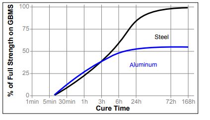

Any reason to use gasket sealant on the bypass cover gaskets?
Manual doesn't say to, so probably a dumb question, but just curious.
Wait at least 12hrs before starting for cure time adhesion...4 hour cure with primer
