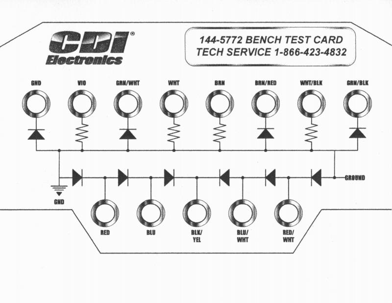

There is a way to ohm the internal diodes and resisters but as posted they are non repairable. I can post the diagram if you need it ......
If you could that would be great, I've been struggling with this motor for awhile and don't want to put anymore unnecessary parts into it. Thanks for the info galamb, the problem I am having is that cyl 1, 2, and 3 will fire multiple times according to my timing light. I have already replaced the trigger and the flywheel(the old center hub had cracked magnets). Does this sound like a symptom a bad switch box could cause?
Here ya go......these was made to be printed out and laid over switchbox when testing.
