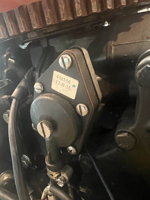

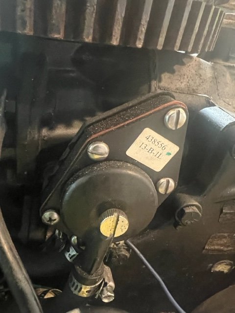

A 1989 model.-----Do a spark intensity check.-----Does spark jump a gap of 7/16" on a test device ,on both leads, yes or no ?----Post results of a compression test.----Post picture of the fuel pump that is now installed on it.

Compression at both cylinders is at 170'sh and I've attached photos of the fuel pump. I wish there was a way to attach a video of what it is doing but not sure there's away to do that.

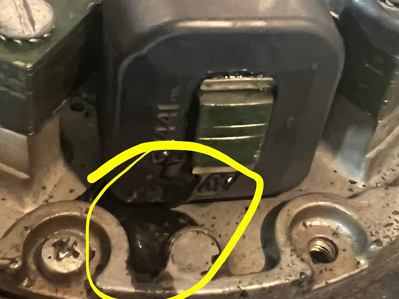

I just got the flywheel off and nothing seems broken. However, I did notice there was a sticky black substance that seems to have leaked out of the bottom of the charge coil (maybe melted plastic??). Could this have been fried during the overheat? Could a faulty charge coil cause these symptoms? Photos attached.
Thanks Racerone....is the CDI unit the same as the UFI pack?
Also, I just attached pictures of the underside of the flywheel and charge coil. The charge coil looks to have some of its potting material melted and smells burnt. I would like to test the coil but can't find my darn service manual...I think my wife has hidden it.
