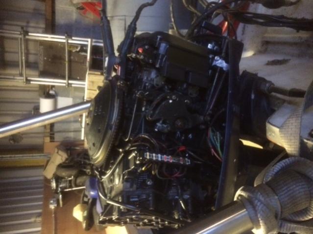

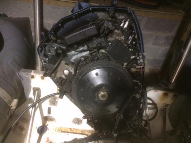

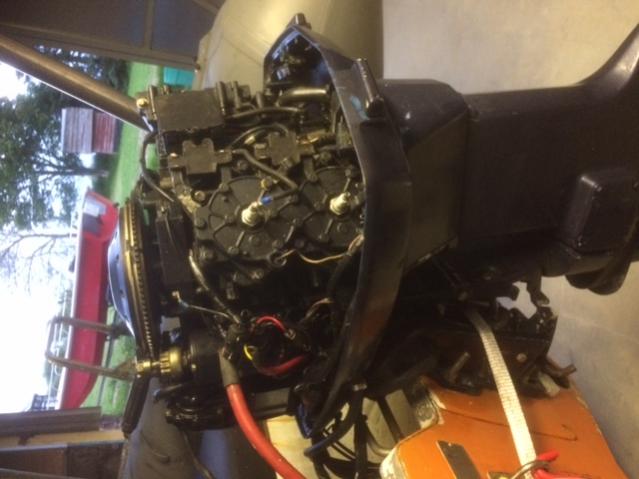

thanks lads will post some pictures later . so could i make my 90 a 115 or 140 hp ?
Sorry, but I sure agree with Daselbee as BRBs' customers service is getting worse. Noticed this on other forums also.
thinking its around 88 would i be correct ?
