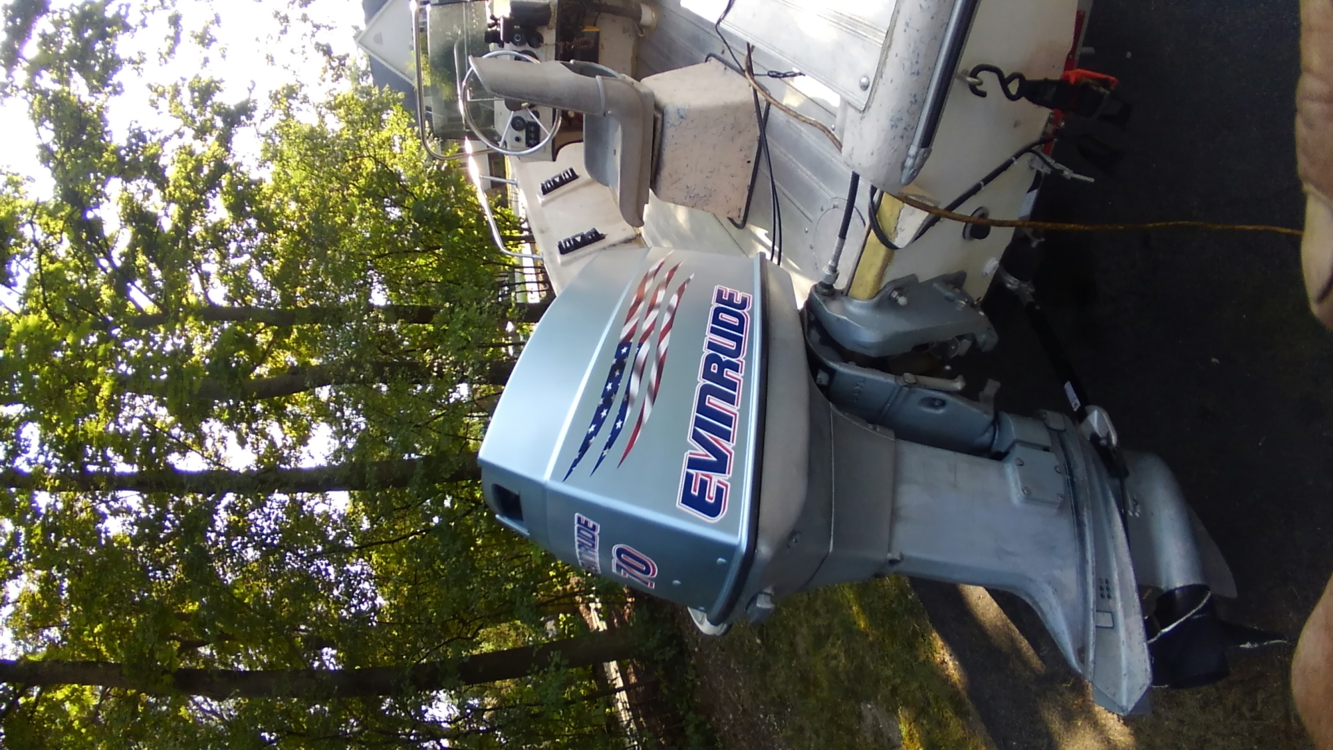

The last time I was out fishing on the Mississippi, my engine developed a knock.
I pulled and disassembled the power head, everything looks great. Slight discoloration on the connecting rods, and a little carbon on the top of the pistons.
My question is, what do I seal the two halves of the "cylinder block/crankcase assembly" with? There is no gasket or "O" ring. I have some Loctite 515 gasket eliminator that I've used on centrifugal chillers in the past. Will this do the job?
I've also used high vacuum grease on "O" rings in the past, A silicone based lubricant to extend "O" ring and oil seal life. Is there any reason not to use this? Would it help in the labyrinth seals between cylinders?
I picked up a gasket set here (P/N 0439084)
I'll be pulling the lower end and checking the gearcase soon.
I wanna get this back together and running before the Ohio Walleye run in April.
