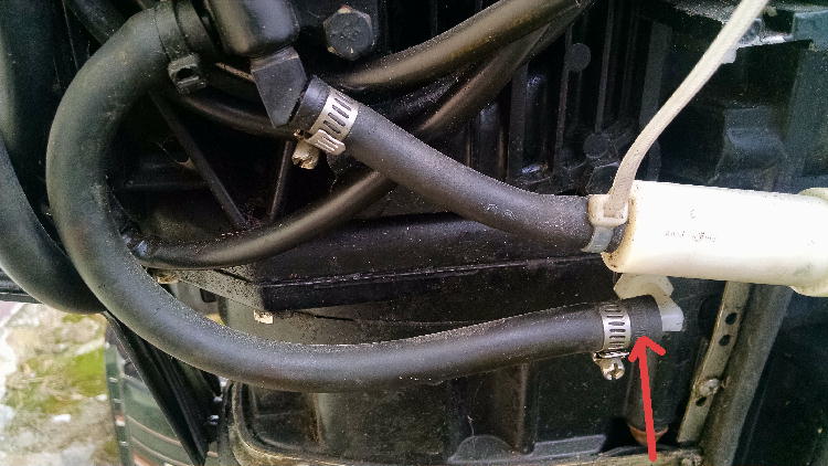

Since you mentioned this on my other post, I am going to assume it is important. First, I want to verify exactly what I am plugging and by plugging, do you mean cut the line and plug the line coming from the exhaust adapter. (This is all greek to me). The pictures shows where I assume you are talking about. Now by me doing this, what will now happen to prevent my top piston from getting fried. Was this just a design flaw? I assume if it works correctly, the engine is fine, but if it fails, I will not get enough water to the top piston.

That's the one but, before you go any further, do a compression test. It may already be too late for the top piston (as I've found in 3/4 of the cases). Depending on the tester used, you should see about 130 to 150 pounds with a variation of less than 15 pounds.
All you need is to put an 1/8 NPT pipe plug in that hole.

Sounds good, thanks for your advice. I will get that 1/8 NPT pipe plug and I will also make sure I replace the impeller. Any quick tips for removing lower unit on these motors and re-installing them.
