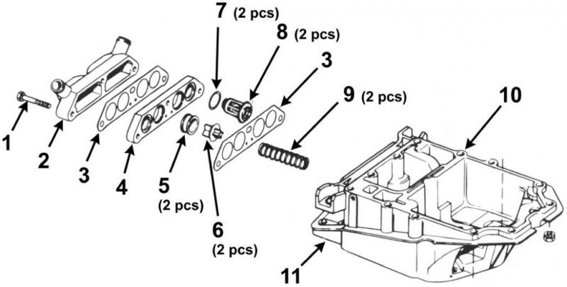

Yes, it did. I put the bigger of the two keys in, and it sheared off. Never had one do that before! So THAT problem is solved....So I went and got another key, but have another problem. One head consistently gets hotter than the other. It seems to me to be thermostats, but those have been replaced when the powerhead was done. One thing I did notice, the water pressure on the gauge is inconsistent. At idle, it will read 5lbs of pressure. Then, the starboard head was the hot one this time. I had the port side heat up the last time. I'm lost as to why it's doing this. So I pulled the hoses, started the motor, and had great water flow from those hose at that time. Hook the hoses back up to the thermostat housing, and it heats up again. What temp are these thermostats supposed to open? I pulled them and checked them, and they both opened around 155 degrees, which to me, seemed almost too hot as the book calls for a max temp of 163 degrees. Think I have bunk thermostats? I can't seem to locate anything in the book about testing the opening of the things. Another thing, they don't open fully until the temp on the pan of water is over 170 degrees. That seems awfully hot for them to be fully open if the hot horn will sound at 180 degrees. These are the Seirra branded thermostats.
On v4s&v6s for some reason one side usually runs hotter than the other.My friends 225 runs 20 hotter on starbord than port.nature of the beast. Do u know the specs on the stats that were installed. they should be 143s,im not sure, thosestats dont open up much more than three eights-half inch.170-180 is too hot.I would look for cooler stats. A heat gun would come in handy,If you can keep your bare hand on a head for a six second count without burning your skin your ok
You are installing them correctly???
