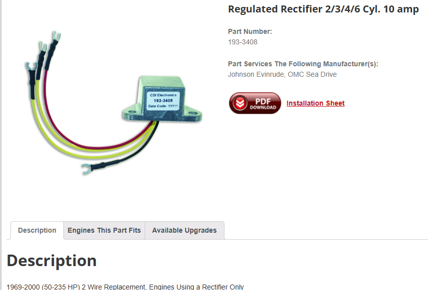

I got a boat with a 1983 Evinrude 70HP E70ELCTE motor last summer. Shortly after getting it (and it could have been doing this the entire time) I noticed that the volts were reading very high, around 17 volts. I switched to a different battery and it seemed to be normal for a while, but then it started doing it again.
I know that it seems to be that a regulator is bad, but would an engine this old have a regulator? Looking at this exploded part view https://www.crowleymarine.com/evinrude/oem-parts/outboard/1983/e70elcte/ignition-system i can see that part 43 is only labeled as a rectifier, not a regulator/rectifier...as shown by this link https://www.crowleymarine.com/evinrude/products/0583408-rectifier-lead-assembly
Any tips on my situation? Is it the batteries job to act as the regulator and i just have 2 bad batteries?
Replace it with this...problem goes away
