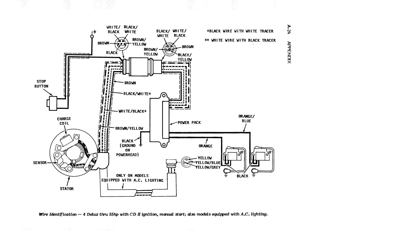

Hello Folks Im new to the whole boating world and got myself in a bit of a predicament with a boat i just purchased second hand.
Needs a little repair waterpump, gaskets, etc which im gonna tackle on my own but im curious to if i can charge a battery for a trolling motor with this model i do have wires coming from flywheel that lead into a few different spots am i able to somehow turn that into a charging system like i see other people do with other motors? i attached a copy from the manual of my wiring setup
