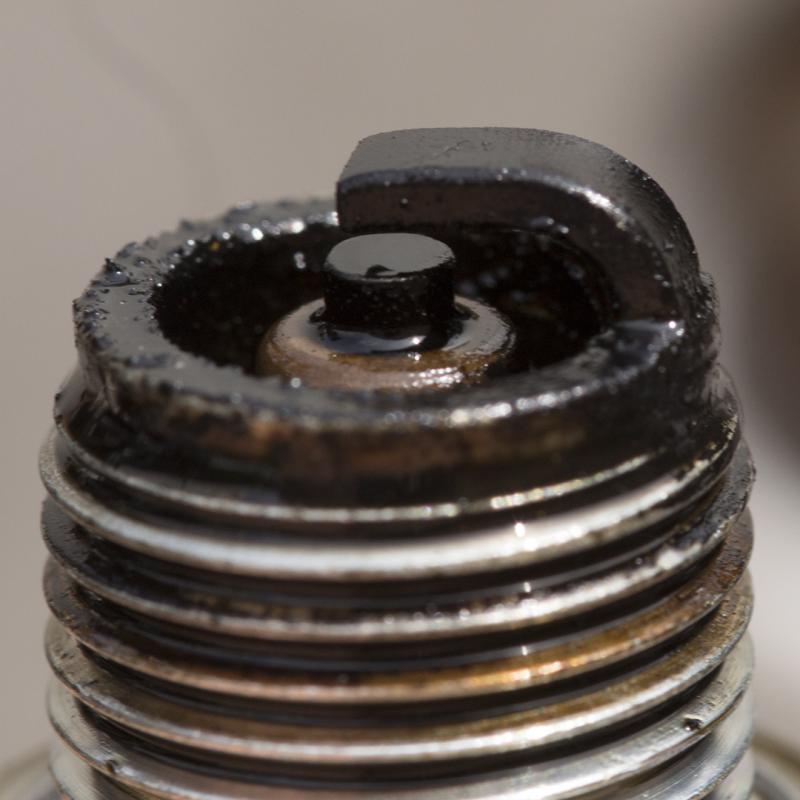

All four spark plugs present as wet fouling.
The plugs were cleaned recently and gaped to .030.

Where in Canada ??----Are the thermostats installed and working properly ??------Do you have spark on all 4 that jumps a gap of 7/16" or more ?-----Plug look ok to me.
Lake Simcoe (Ontario). I can't say if the thermostats are stuck open but there is no sign of overheating. I can measure the head temps with an IR thermometer next time I am out unless running it in a barrel is good enough. I'm making a spark tester and should have a video for tomorrow.
Along with the video, make a blunt statement of the spark... that is whether it actually jumps the 7/16" gap with a strong blue lightning like flame... a real SNAP!... or not! A weak spark will result in spark plugs like that graphic shown.

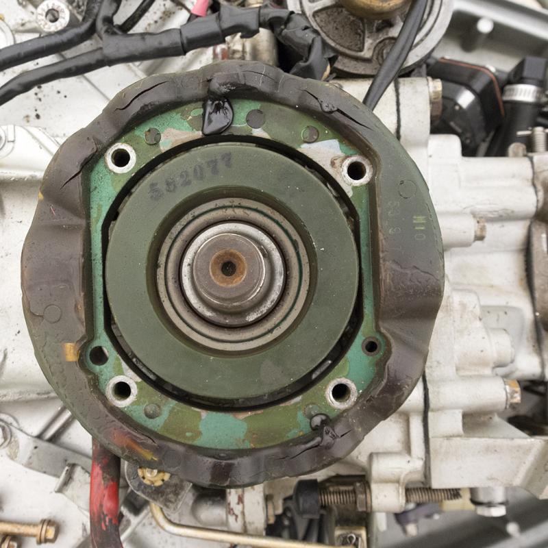

Observe the stator under the flywheel closely to see if there might be a sticky looking substance dripping out of it, down on the powerhead area. If so, replace it as that would cause a AC voltage drop to the powerpack's capacitor which would in turn result in weak, erratic, and eventually no ignition/spark.

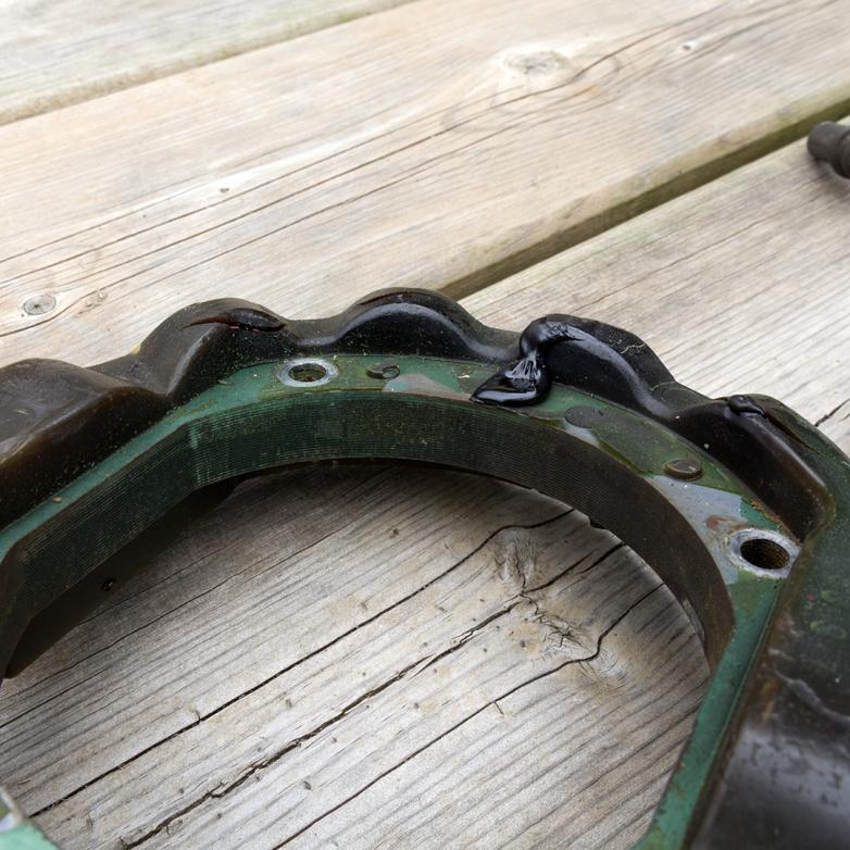

Is this what you are talking about?
Well, that certainly looks like a sticky looking substance... NOW, how about telling us verbally and with a graphically view of the stator (excellent pic taking by the way) as to where that goop is coming from. Actually there's only one item whereas that could originate (stator) but we'd like to see it anyway. That's the worse meltdown scenario I've ever seen!
To answer your question... Yeah, that's what I'm talking about.
I don't have a flywheel puller yet so I can't do a overhead shot but the goo on the right side (top photo) is where the timer base connects to the throttle linkage.
On the left side (bottom photo) it is just aft, about two inches, of where the wiring harness goes into the stator ring.
James.... The view I would be interested in would be the bottom extreme forward & rear portion of the stator. That's the location of the sealed in larger coils (1 in each location) that supply the AC voltage to the powerpack capacitor. And as such, that's the specific area whereas one could see the leakage point. No need to pull the flywheel to view that area.
I had a look and didn't see anything at the front or rear. just on the left and right sides.

The sides.... That would normally be where the battery charging coils are located, and I've never seen any of them melt down... just the large ones fore and aft that provide power to the powerpack capacitor. Makes me wonder if that stator is installed sideways, if that's possible... never tried that.

If the stator is indeed leaking, dripping down a sticky looking substance on the timer base and the power head area (a situation you will need to determine)... the stator will require replacing regardless of what readings you obtain from it.

Those two large coils are what normally melts down. They supply AC voltage to the powerpack.
The meltdown on that stator shows a leakage of the battery charging coils. That type stator basically has existed since 1973 and I have never seen a meltdown like that (Battery charging coils).
