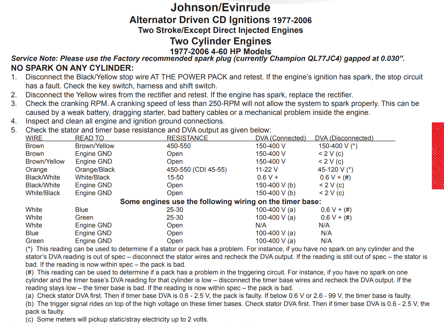

This is a snippet from the CDI troubleshooting guide, i think I got the right page for your engine to check resistances and stuff.
This is a snippet from the CDI troubleshooting guide, i think I got the right page for your engine to check resistances and stuff.View attachment 33896
Thank you for this information. This appears to be for the alternator, which is great information and something I’ll probably investigate to refurbish between seasons. I was able to replace the current ignition coils with replacements that looked very similar from eBay. They measured about 260ohms each on the secondary coil but major difference is the encased core for protection. Engine ran great last time is was out, not stalling or cutting out issues!

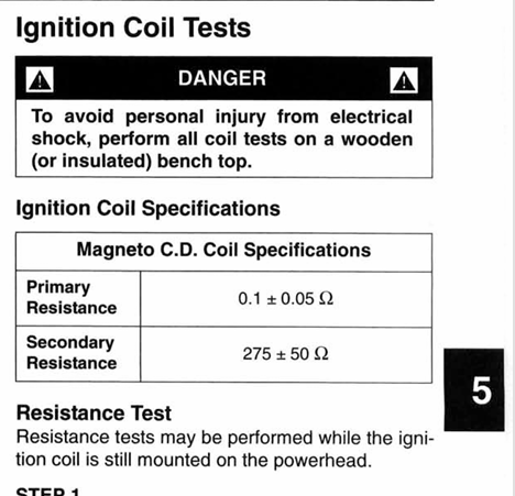

That info posted is for timer base and stator ..here is what you need from factory service manual...
This is exactly what I was looking for and confirms my new coils from eBay that measured 260ohms each are within tolerance! I replaced them both and took her out last weekend and had no issues stalling or cutting out. The major difference I see is the new cores are encased opposed to the old ones being exposed, which may have contributed to the issues I was having.
