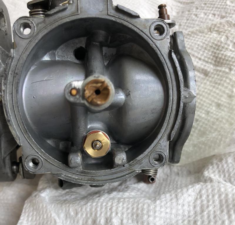

I rebuilt the carb recently and replaced the float and inlet valve and seat. Cleaned the carb and high speed jet. I could tell someone had some struggle getting the main jet out previously. But I don’t see it affecting the flow. Thoughts? I don’t see a large amount or really any raw fuel coming from the exhaust. Not sure if it would be noticeable or not.

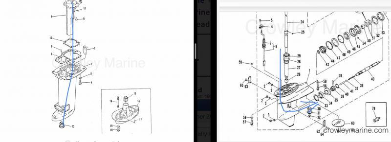

It’s funny you mention the exhaust tube as I was wondering that myself recently. I do notice exhaust gas coming from the prop while it’s on the muffs. But I have also seen some fuel/oil(it’s black) leak out of this area after running the motor. It’s usually a drop or two on the garage floor when the motor is trimmed down. This got me thinking maybe there is an exhaust leak or blockage.
I definitely would replace the jet for giggles(Yamaha) and drop unit to check tube...……...
I plan on dropping the lower unit this weekend. However where exactly would the exhaust tube come loose? Doesn’t the exhaust travel through the housing and out the prop? (Blue line)
