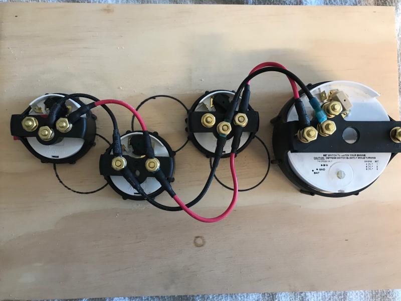

Hey all, I have a 1980 454 with thunderbolt ignition. I just replaced the original gauge cluster, all but the amp meter were not functioning, with new faria gauges. I'm having trouble getting the tach to register. With the key on, the tach needle jumps slightly but while the motor is on it doesn't move. On the wiring harness the brown wire is designated as the tach signal. I cant find much in terms of wiring diagrams online. Any input is greatly appreciated!

Well, I APPEARS to be wired correctly. I've replaced a number of tachs over the years and have found that the cylinder selector switches to be "touchy" to set. Two issues...the "detents" aren't all that definite on some tachs and on some tachs it is not all that clear which end of the pointer is the "arrow" end. In the latter case, you can end up with the switch 180 degrees out of proper setting.

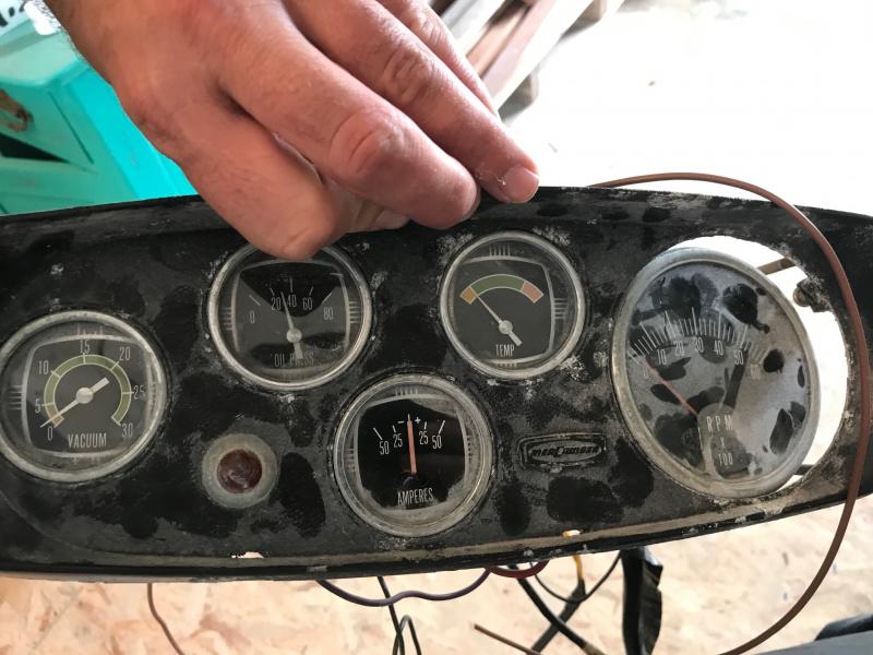

Thanks for the reply. The original tach did not work. Out of all the gauges, only the amp meter worked. All the connections were pretty corroded and weathered. I set the new tach to #3 (8cyl) per the instructions but I didnt mess with it much when the motor was running.

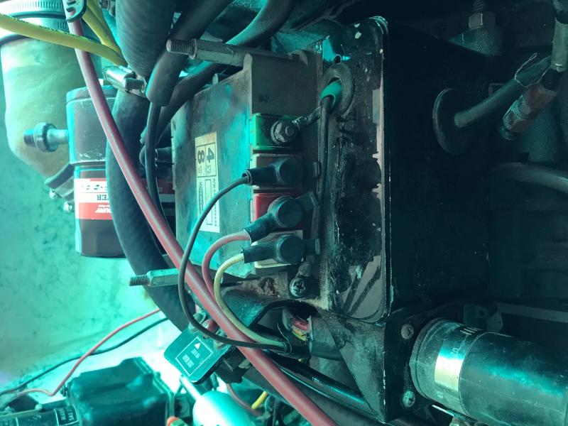

Unless I`m wrong the purple and grey from the module go directly to the coils pos and neg , Tach wire is usually grey connected to the neg side
Fired the boat up today and switched around the pole selector on the back of the tach and nothing changed. Still set for an 8 cyl (#3 position) there’s a purple wire that’s connected to a yellow alternator wire that used to run to an ignition light on the old dash. That wire is currently disconnected. Any chance that’s affecting anything?
I doubt it....did you try moving the tach wire from the module to the - side of the coil ??
Am I looking at this correctly? The coil wire comes out of the box, the positive lead connects at the green terminal on the module and the negative side is grounded to the far left? If so, then yes I moved the brown signal wire to the grounded coil wire with no change in the tach.

I'm thinking your new tach won't work on the original thunderbolt ignition system...the service manual indicates 'special equipment' required to test that system....and its tachometer.
Think your best bet is to contact the tech support dept of whoever's instruments you bought and see what they say about a different tach or a mod to the one you have....

From what I can see, the '-' coil post is grounded all the time and the spark is initiated, from the switchbox, with a pulse thru the "+" post....so a 'normal' tach won't work. To complicate using a new tach, the switchbox likely dumps well over 400VDC when it fires....
