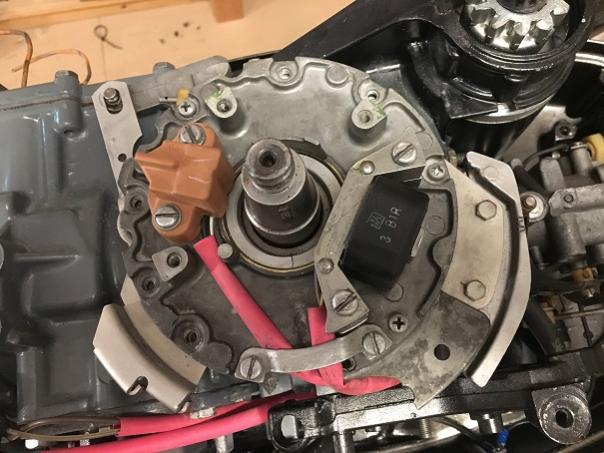

Here is a photo of the mag plate with the coil and sensor. Do they look mounted OK? Can the coil possibly be mounted upside down with the wires on top and still work properly?

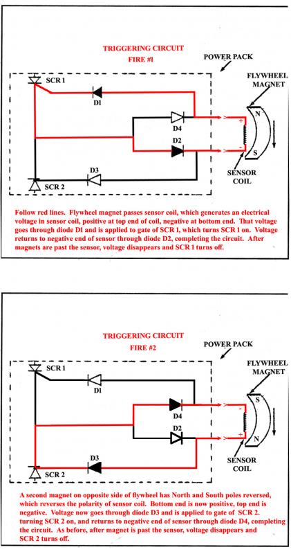

It is physically impossible for the trigger to not reverse polarity. Trigger polarity is determined by which North/South magnet pole passes by first. Magnets on opposite sides of the flywheel are reversed and cannot be changed.
I spent all afternoon drawing this diagram just for you (and anybody else that is interested). If you understand basic electrical circuits with coils and diodes, it will make sense to you. Otherwise, I suppose I wasted my time.

That statement would make sense, except that scenario ain't going to happen.
