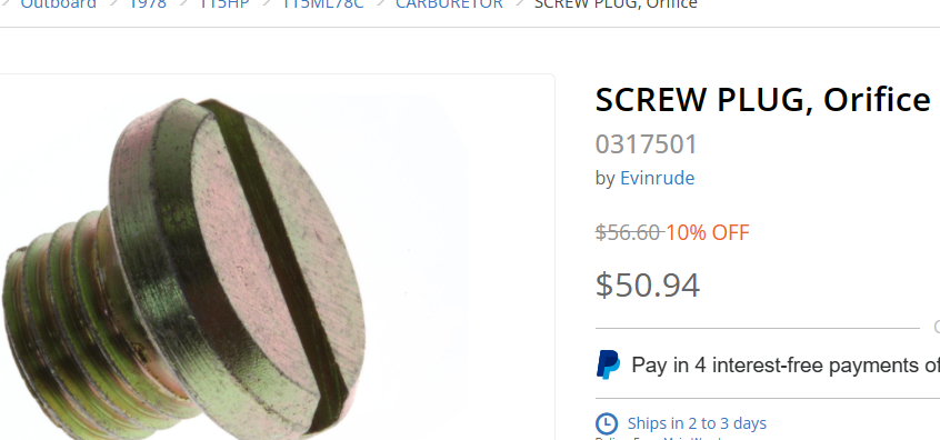

Each carb has 2 of these little screws. One on each side. One is missing. Do you know what the part number would be for this little guy?
You need 2 kits.---You have to wonder why screws are missing on a carburetor.-------Not hard to find a drain screw for a " cold one " here.
It was an orfice screw that was missing. The marina guys noticed when they were diagnosing it. I ordered the carb kits and that screw. I’ll let you know how it goes when I receive the parts. Thanks for your help!
Yes ----I know what one of those carburetors looks like.-----Might have 20 or more laying around.-----One is called the orifice plug ( high speed jet) and other one on the outside is a drain plug.-----Good luck with this motor.
It was the orfice plug. I ordered on and it was $50! Hopefully everything goes ok when I get everything put together. I’ll keep you informed. Thanks for all your information. It was very helpful!
The fuel metering ORIFICE PLUG is listed at $19.99 and for the drain plug I would use a screw from the hardware store at $0.29 ---read 29 cents or less !!
