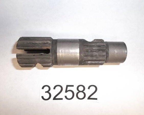

I did some minor disassembly of the furniture and have a better idea of the problem. Cable works, linkage rod is connected to the “steering arm” of the outdrive, but moving the arm does not move the outdrive. When he said it turned one way, it must have been from prop torque. There is no steering at all.
sterndrive remains centered in pics.

100 percent no bueno. You might want to get that spare drive as the one you have must be busted. The steering arm is connected to a shaft with splined ends. It is possible that the gimbal ring could be stripped out.

You are correct, this is an ancient splined shaft rather than square, and the gimble ring is stripped out. Parts obsolete of course.
And I think the whole deal will have to come off for replacement.
