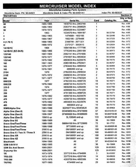

That is what I thought a MC-1, but after looking an index of the year they started calling them MC-165 after the HP of the engine. But im confused about that info.
The out drive has a lift loop on top. mercruiser_models.gifMC Model Index.jpgster drive id.JPG
The out drive has a lift loop on top.View attachment 25554View attachment 25555View attachment 25556
if it has the lift ring it’s an mc1 drive , interchangeable with the R, MR, and AlPha One Gen ones.

MC1 drives were built from 1967-1982 with some minor revisions - they at times named the drives off the HP of the motor but its an MC1 drive.
The R (1983-1984) and MR (1985) were two versions of drives that fit up to the same bellhousing etc as the MC1 drive but visually look different. There is no eyelt on the top like on MC1 and the R. MR, and later alpha one have a squared off (in the back) cavitation plate vs the round cav plate on an MC1.
1986-1990 the MR was renamed the alpha one.
The good thing is all four of these drives MC1, R, MR, Alpha One Gen one are interchangeable (drive ineternal parts have some differences), so even though your drive is older you can buy a newer gen one drive (or SEI aftermarket replacement) and bolt it in.

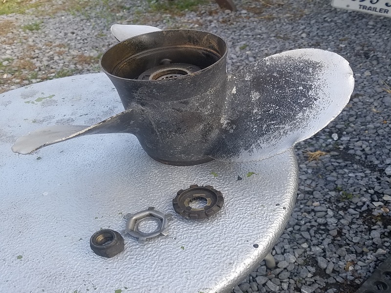

the propshaft will have in an out play, that is normal, but you shouldnt be able to wiggle it side to side.
What should be there on the prop in terms of washers etc depends on if you have the older pressed hub or newer removalble hubs. Figure out how to post a picture and lay it all out on the table .

How do you think the PO broke off my caviation fins with wood while removing the prop?
Prop Numbers 48-78120-19 it has 15 spline teeth and a L at 9:00 and a K at 6:00
Is it a 19 pitch?
Thanks for all your helpprop off.jpgcrack in lower housing.jpgcavation plate broken.jpg
Based on the pic with the crack, and the cavitation plate being broken,That lower unit is done, No good and cannot be repaired or used at all.
So that settles that!
That is a 19 pitch prop, Yes. The other numbers dont mean much for your purposes. Merc props are what they are. the pitch is what is important.

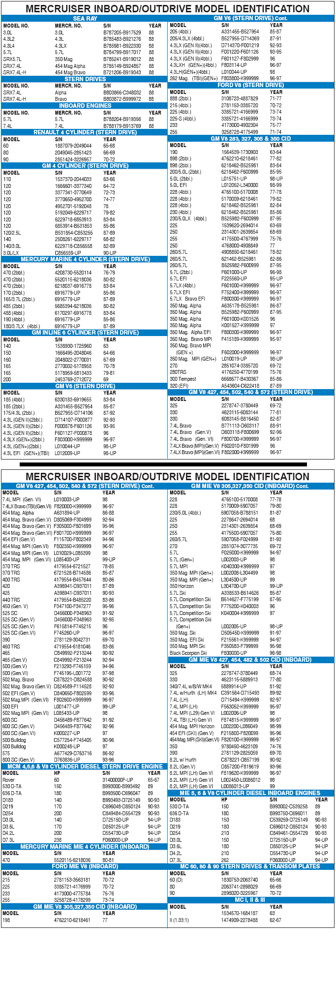

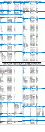

Doesn’t look to match the part number in the drive drawings here at marine engine
http://www.marineengine.com/parts/mercruiser-stern-drive/index.php
put your drive serial number in will give you correct parts for it ( and engine if use that serial)
ithink it’s shown under the gear case drawing when u get into the drawings fir that drive

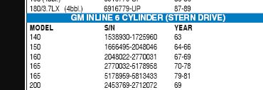

According to the my owners manual the engine s/n is 448445
stern drive s/n is 522399
how does that relate to a MC-1 or a R drive
There is one digit missing. Serial number have 7 digits
Please try again
Example
Ratio Serial Number
MC-I
Ratio ..........................Serial number
1.65:1 ...................... 4890460-6268064
Thanks Dieter
