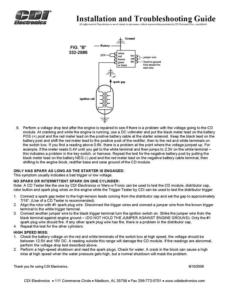

It is new to me and I will try and test it this evening.No the rectifier charges the battery only - if the battery is below 9v it might not spark or if the white and red wires on the switchbox aren't energized with 12v, make sure the connections on the battery are right.View attachment 23304Is this a new to you motor?
You might have a damaged trigger use these steps to checkView attachment 23311
Could have sworn I tested the trigger assembly when I had a spark problem; dusted off my shop manual published by Brunswick Co. and looked at page 2A-2 'Electrical and Ignition'. There is a 'Trigger Assembly Test' using a VOA meter: 1. Disconnect all trigger leads from switch boxes. 2. Between the brown trigger lead and the white/black trigger lead, the Ohms should be 700-1000 (mine was at 841). 3. Between the white trigger lead and violet trigger lead, the Ohms should be 700-1000 (mine was at 839). Resistance specs are for a room temp engine. Also disconnected the battery from the engine. Maybe there is another test.You cannot test this trigger with a ohm meter...
