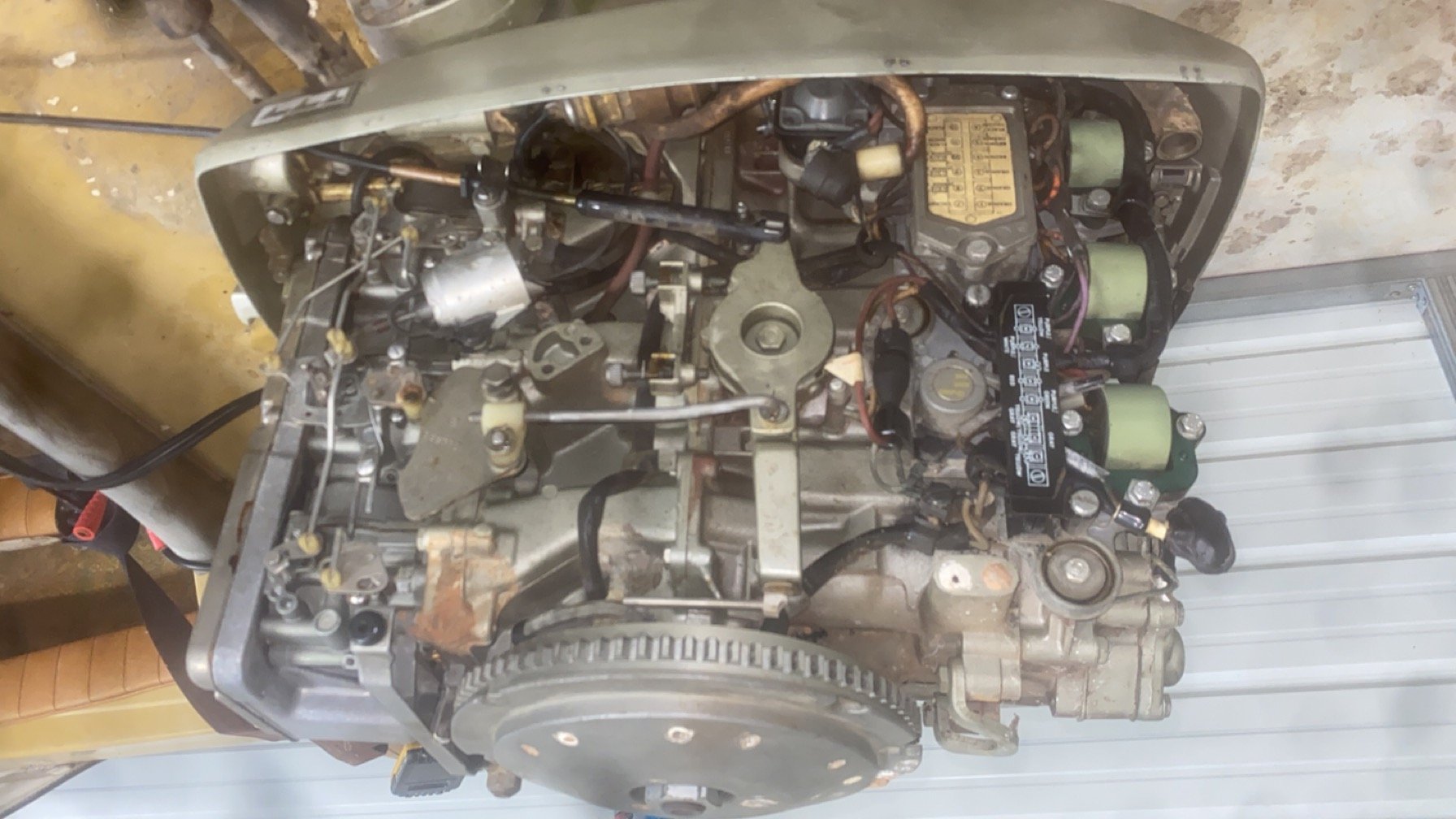

No spark on all 3 cylinders, disconnected kill wire, same deal. Not sure where to go from here… just bought the boat, no response from ignition either but I see voltage change with key at the starter solenoid, so I assume bad solenoid there. Where should I check next for spark? I simply disconnected the black/yellow from the power pack. I’m not sure how to test the power pack itself.

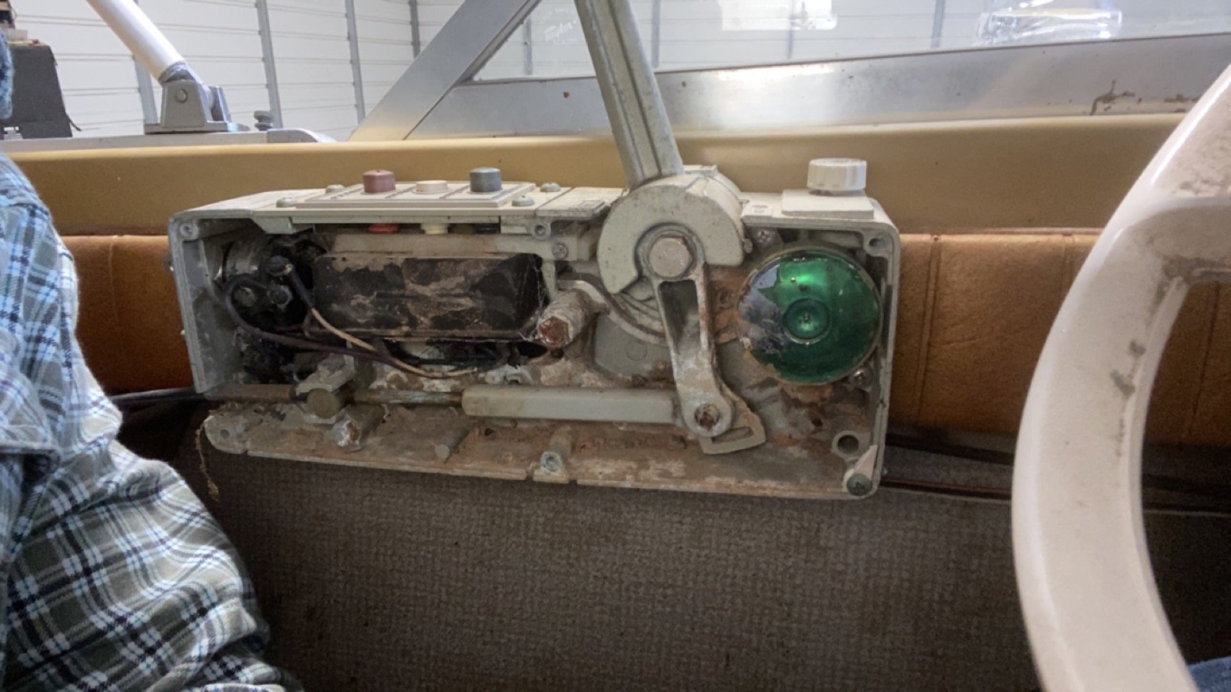

Do you hear solenoid click? Throttle advanced to far and safety switch engaged?
When I turn the key I hear nothing at all. I haven’t seen any switches. I will say this motor was up and running in 2001, fuel drained and sat since then. I’ve played around with different throttle positions, but no click at all.

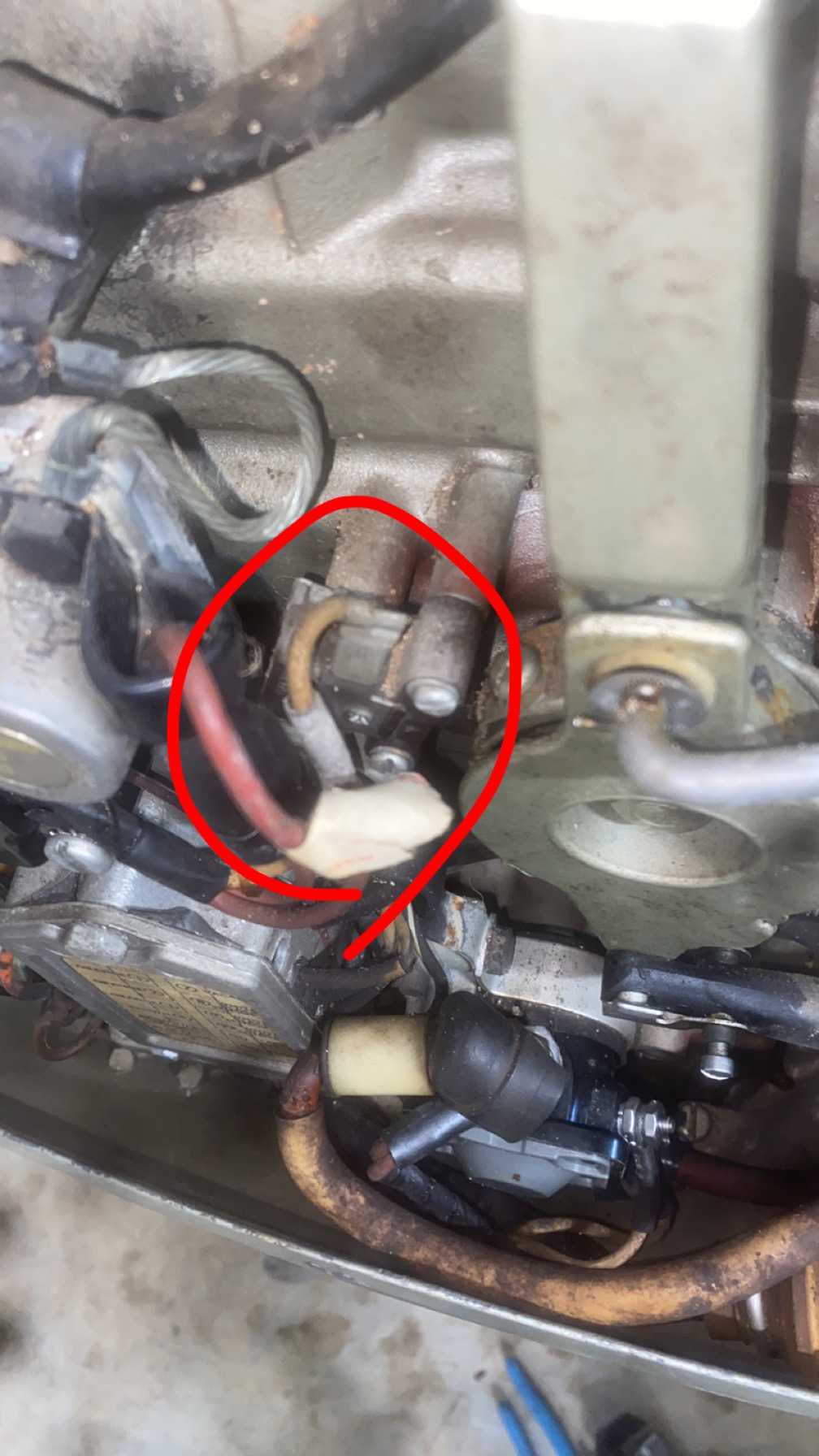

There maybe a " start in neutral " switch in the control box.-------There may be a switch on the engine block near the throttle arm.----Only one white wire needs to go to it.----Remove that white wire, then ground it to the block.----See if motor will crank.
Would this be the switch?
