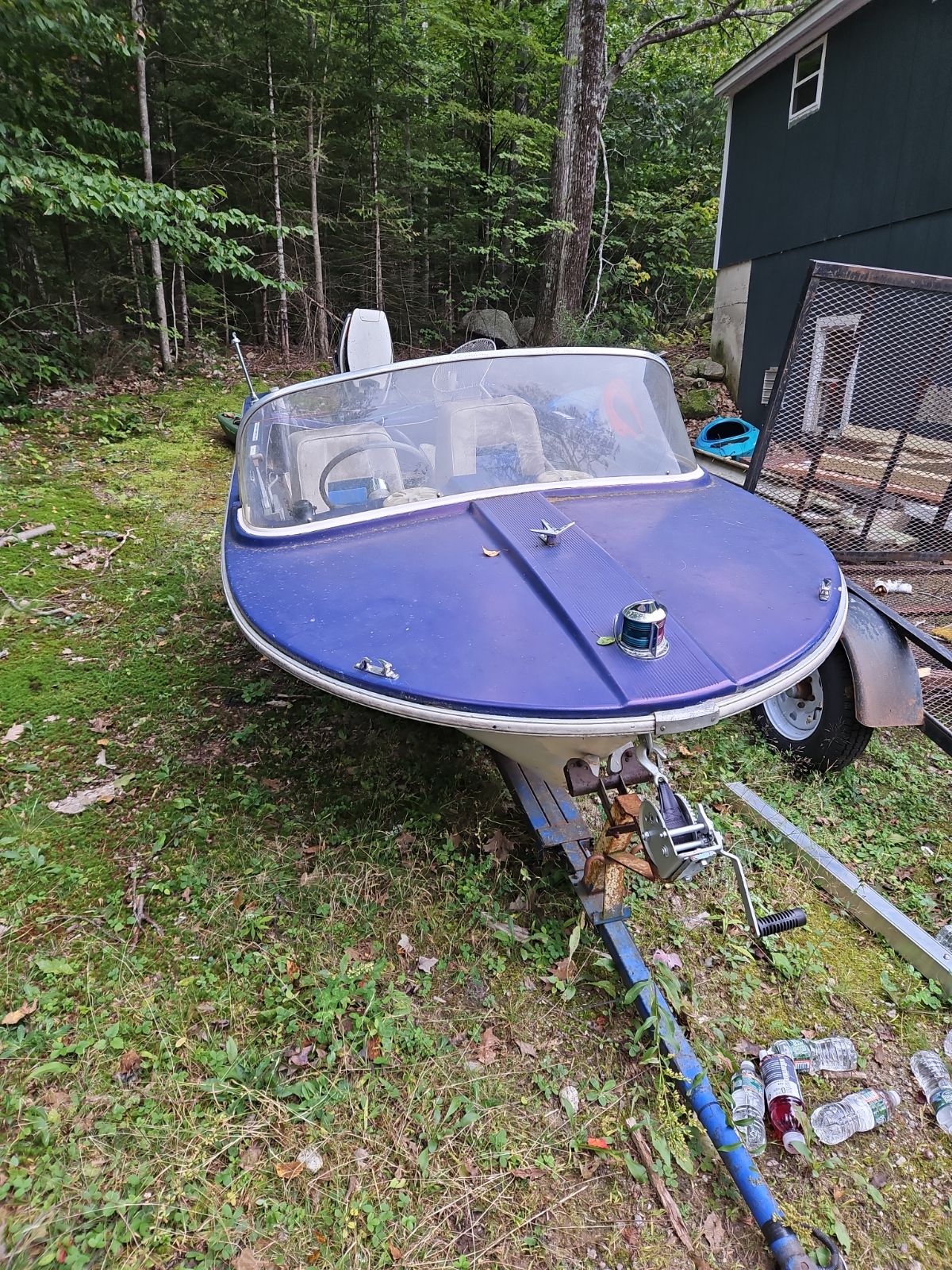

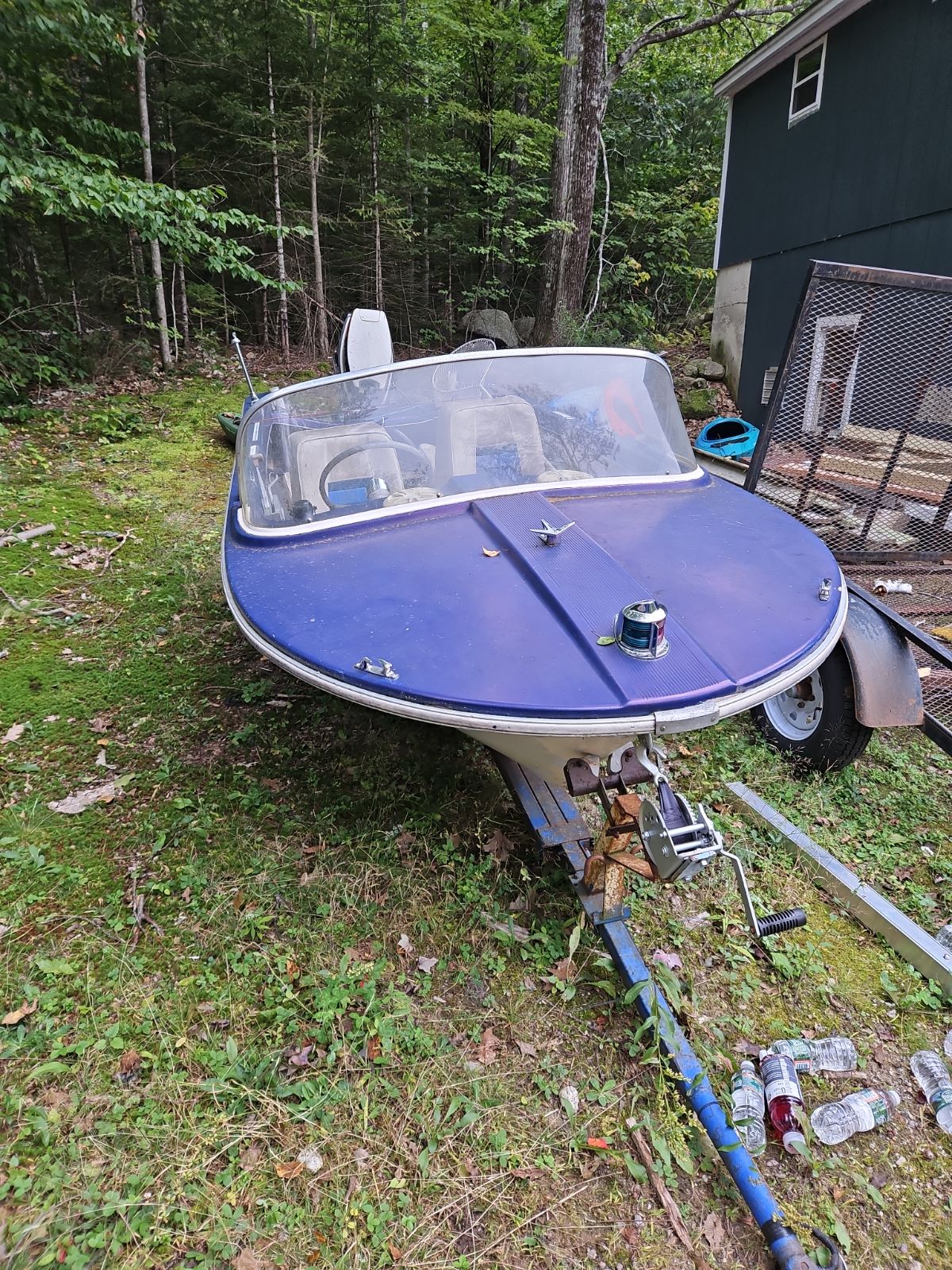

Hello All
I received the below for free. Please let me know if this is worth keeping or selling or just downright dangerous and should be trashed.
It was a package boat, trailer, motor.
Thank you, some soft spots in the floor. Is it possible to just lay marine plywood over existing floor?

Cut the floor out----Inspect / replace stringers.----Replace plywood in transom ?-----Glue in a new floor.-----Enjoy a simple boat for years to come!
