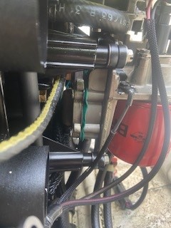

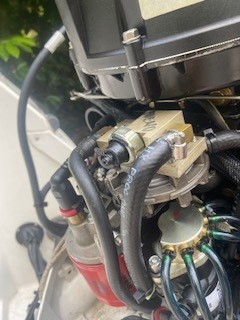

Im confused....
Whats the block on top of the waht i think is the oil pump ?
The fuel pump im guessing is the one with the blue gasket behind the fuel filter ?
That is a Ficht motor. Stop using it till you find problem. It will not run on pre-mix fuel! What you see id the oil lift pump and pressure sensor.

Im thinking the oil lift pump & pressure sensor need to be changed out along with the fuel pump.
Does anyone know where i can find the proper info for E175DPXABB Ficht motor ? The parts catagory doesnt show the ficht model.
