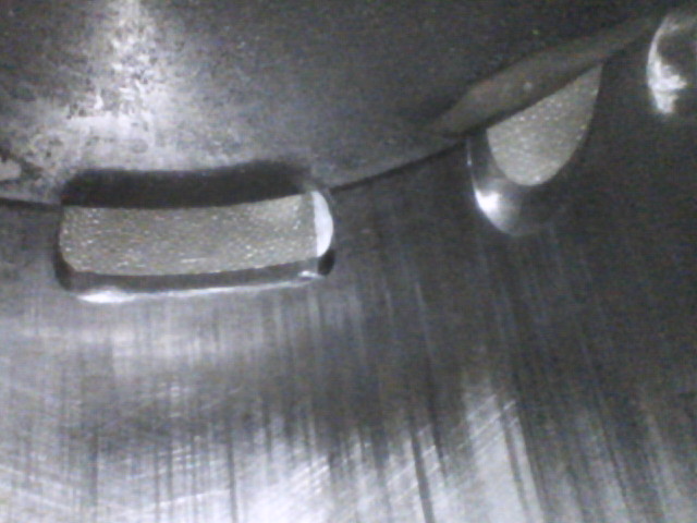

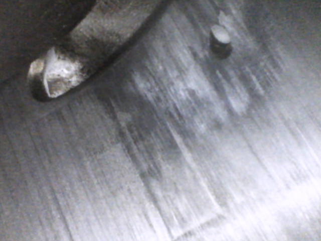

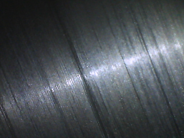

I believe the thermostats are brand new also although I have not double checked their operation. The engine dies suddenly no sputtering. If the weather ever warms up I am planning to do a bore scope inspection of the cylinders. I suspect if the cylinders are grabbing the pistons and stopping the engine I would be able to see the evidence on the cylinder walls - agree?
attachment.php
BK560008.JPG these are the pictures I took with the borescope! pretty self explanatory I think. sorry about the sizing of the picture - not sure what happened.

Looks like a lean seizure. Can you post pics of all 6 piston domes? The piston wash on the dome that is visible is a bit thin. You should see a clean spot by each intake port about the size of your thumb nail. Those tiny slivers of clean spots look like the cylinder was starved for fuel.
Did a shop do the work or you? It sounds to me the original cause of your first engine failure wasn’t solved during the rebuild resulting in the same problem again. Unfortunately this engine needs to come apart again. If a shop did the work will they warrantee the engine? If not it’s either rebuild again or you can just install a reman power head.
If they put a Seizco piston in they likely did not clearance it properly and it was never tempered when broken in. You have to let motor reach operating temp before WOT usage with Seizcos
^^^^This^^^^^^
I've not rebuilt an outboard before, but I've done several 2-stroke PWC engines. Wiseco pistons are definitely a fickle deal, so if that's what you have in the motor that could explain your problem. I've never had an issue with WSM pistons, but Wiseco definitely has to be up to operating temp before you give it the juice. If you don't, galled cylinder walls just like yours can happen.
