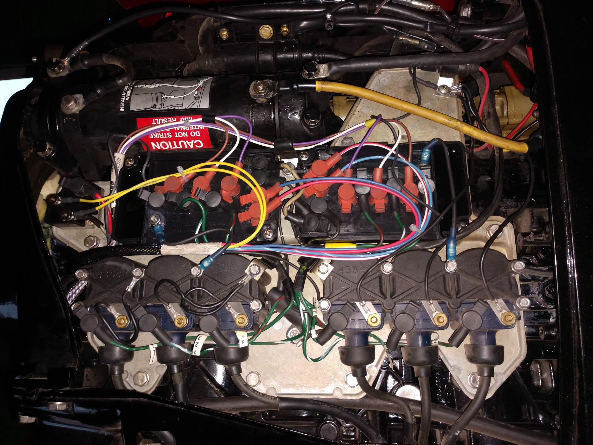

Hey all,
My 1994 115hp uses old style ignition with single CDI module.
I would like to convert to the newer CDM type coils that i have purchased.
I'm already running newer style red stator. My question is can i still use the older type trigger? i noticed the newer trigger has an extra wire to ground.
Appreciate anyone's help with this before i dismantle all of the electricals.

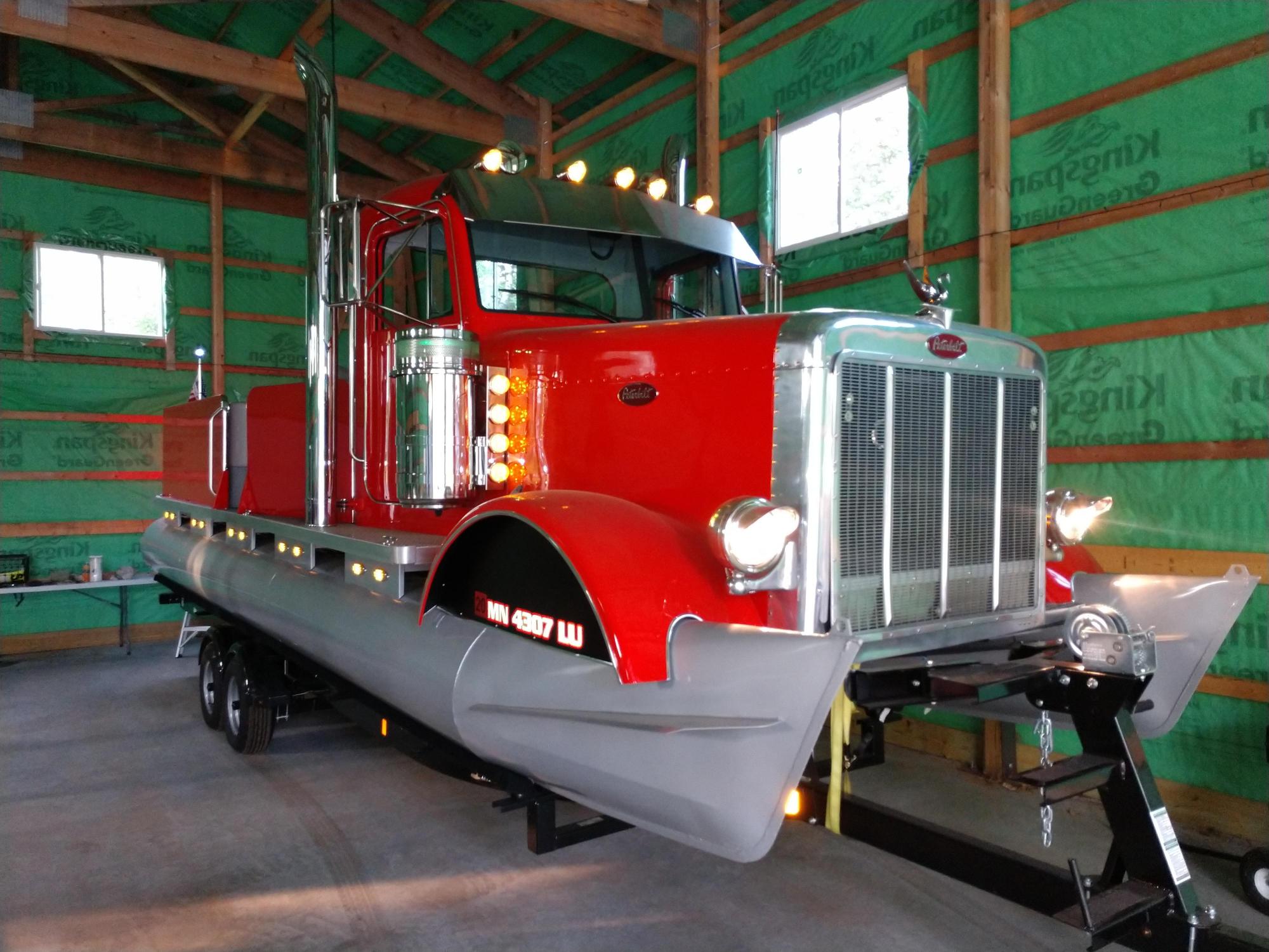

The older triggers are fairly common failures. My 115 has been all redone with CDI parts about 10 years back. Just did a 90 horse "tower". The owner said it has never ever run so good, all CDI stuff installed, but still has the original 1986 coils. They not only tested perfect, but run perfect. Not so sure the newer style coils are even as good. Here is his boat. Pretty frickin cool. He built it himself from an old 1986 Pete. Added a center pontoon.

You would have to change: trigger, ignition plate wiring,stator and flywheel. Doable if you find a wrecked motor
I never saw anything like that before. Getting a tour and reasoning of/behind the whole idea and construction including pictures would really be something to see/hear.....think he is game to tour us?
The guy, Jeff Foster, started a trucking company in his early 20's. Very talented driver, tradesman and mechanic. Has his own Cessna too. He even bought and restored an old great lakes ice breaker, saving it from scrap. I will call him and see if he has the build documented. He at first wanted to go to a newer 4 stroke, he was having trouble finding someone to work on the "tower". As you might guess, he is quite busy to play on his own stuff anymore. Still has his first car, think it's a 56 Bel-Air with 283 4 speed. Really neat dude....thinks WAY outside the box.
