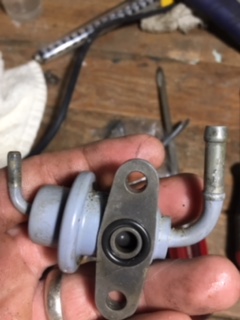

I took the Regulator off and actually tried to blow a breath through the side that attaches to the fuel rail. I couldn’t get any air through the Regulator and out either side of where the vent or the fuel tube attaches. So I assume this regulator is bad. I will find out tomorrow when the new regulator comes in I will try the same test.

Bryan - not sure you should be able to blow air through the regulator. It is my understanding that if there is no vacuum on the regulator, the spring in there will close off the fuel return line altogether.

Well got got the new Regulator and pump in and installed it all yesterday. Every filter/screen on this motor has been replaced, even the fuel rail screen. After I got all the vst assembly back in I detached the fuel line after the Regulator from the fuel rail and got around 2 fluid oz. that the book calls for.
Put the motor on muffs and it and it ran the way it was supposed to. Now the test will be if it continues to run fine!?
The last pump pump I put on did well for about 30 min and then quit. So let's hope for more than a hour run ahead!

Well, I took the boat out today and ran it for an hour. Stopped and idled, ran full throttle, and stopped again. Changing the pressure Regulator seemed to work. Time will tell. We will probably plan on running only ten miles or so on the next trip to make sure.

Had the boat out yesterday and ran it for another couple hours. The pressure Regulator must have done the trick.
